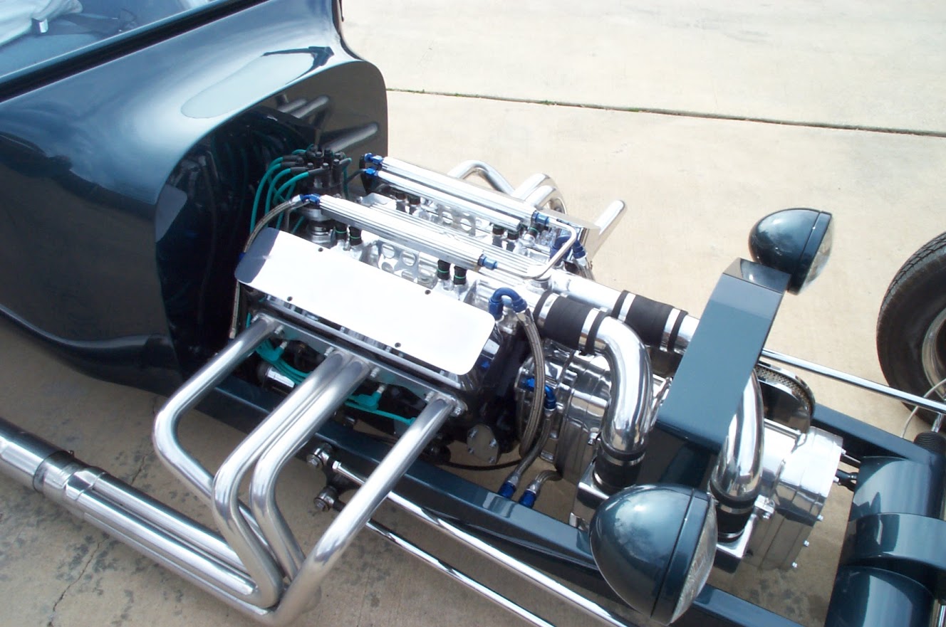

I've been baffled by a seemingly simple question for months; maybe different minds can see what I can't. I have a car with two electric fans on the radiator. They are controlled by a Painless Performance F5 dual fan controller (http://www.painlessperformance.com/webcatalog/fan5)
This unit reads coolant temperature and turns on the fans at 50% speed at temp T1 and ramps up the speed to 100% at temp T2. T1 and T2 are chosen by the owner (see the manual on the site for more info). Not typical PID strategy, but a process control loop of sorts, right? Here's my question: the coolant temperature stabilizes somewhere between T1 and T2. At least that has been my experience with the unit. But is there a way to predict that temperature? Will it vary with the ambient air temp? I first assumed it would vary with system factors like radiator size, air flow, and coolant flow rate; in other words, the cooling system efficiency. Or would it? Or would the fan speed just adjust to compensate?
But unlike usual process control loops, there is not a setpoint. So what determines the eventual temperature? I have noticed a small change in running temperature based on driving conditions. More load (highway speeds) causes the temp to increase, but only a few degrees. And how does one decide on T1 and T2? Do they even matter? If you set them very close, would the system become unstable?

Engine coolant temperature has as many variables as there are keys on your keyboard. Ambient air temp, under hood air temp, humidity, radiator size, radiator construction, radiator color, radiator location, radiator inlet and outlet size, radiator design, coolant used, coolant routing, engine design, thermostat setting, cooling system corrosion, heater size, heater operation, air conditioning presence, heat load on the air conditioning system, vehicle speed, air flow through the radiator, grill design sealing between radiator and radiator support-hood, water pump design , water pump speed, cooling fan(s) size, sealing between fan(s) and radiator, fan shroud design, sealing between shroud and radiator, engine size, engine design, engine speed, engine efficiency, engine tune, engine load, transmission design, transmission efficiency, torque converter design, torque converter efficiency, transmission cooler design, transmission cooler efficiency, Tire size, axle ratio, tire air pressure, body shape, driving style, road surface, road elevation, road incline, just off the top of my head. If you can quantify these variables, we might be able to answer your question. Good luck, and happy motoring.

OH! Well, that clears things up some. To the list you can add manifold pressure, and fuel mixture variances. You may also want to consider the location you are picking up the coolant temperature at. Your SBC should have three different locations for temp sensors. Between cylinders 1 & 3 or 6 & 8, in the cylinder heads, and in the intake manifold front water passage. The cylinder heads tend to be hotter than the manifold, and the rear location(6&8) tend to be hotter than the front (1&3). But, the best location for your use, (in my opinion) would be the temperature of the water going into the water pump after it has been cooled by the radiator, or whatever else is cooling it. If your coolant is leaving the manifold at 195, but returning at 160, there is no need to turn on the fans. But if the coolant is leaving at 195, and only cooling to 190, then you need the fans on.
I would suggest that you monitor coolant at as many places as you can until you are satisfied that the cooling system is protecting your Cavalier sorry, roadster. There are heat crayons that have specific melt temperatures. If that was in my driveway, I would rub a bit of different crayons on the heads between each pair of the exhaust ports, as well as the points where the coolant heads to the back, and the water pump inlet. If the engine temp gauge shows that your coolant is below 240 at all times, but one of the cylinder heads is showing that it melts a 2 60 crayon, I would think that you would want to drop that coolant set point some to keep that head temp lower. BTW, if you need to store that somewhere for the winter, let me know always room for it in my driveway.

Bob, I can watch the temp at 5 places now! The fan sensor is in the block between 6 and 8, there are Moon gauges each side of the intake manifold, the dash gauge sensor is between 1 and 3, and the EFI sensor is in the radiator.
Cooling was marginal when I first built the car due to the low coolant flow rate (my electric pump is a marine bilge pump, about all there was 20 years ago), but I studied up on coolants and system pressure, and now it runs year round without problem, even when I lived in Death Valley, TX. Here's a white paper some wise guy wrote about it: https://tbucketeers.com/threads/cooling-secrets.12176/

I don't think it is PID control, but proportional only. Then the actual temperature will vary with operating conditions. Entering T1 and T2 sets the proportional band. I'd expect the system to end up about midway between T1 and T2 at average conditions i.e. average engine power hence heat load, and average air temperature and car speed. Then if conditions change e.g. colder air, the temperature reaches a new lower equilibrium, at a lower fan speed.

This control strategy, with no setpoint, fascinates me. I suspect that by fiddling with T1 and T2 one could attain a desired "pseudo-setpoint", a temp that would only vary by a few degrees due to air temp and engine load. I wonder what adding a little I to the P would do. I don't remember ever using D in the process control systems I did many years ago. Guess I need to get a real PID controller and do the experiment. No rest for the weary.

I'm not an expert on control systems, but I believe it's usual to enter a setpoint and a proportional band. Entering your T1 and T2 is doing the same thing by a slightly different route. Reducing the width of the control band gives tighter control but can cause instability.
If it's proportional only control there is an offset if the inputs change, as that's the only way the system "knows" to change the output. Integral control avoids the offset by in effect adjusting the setpoint (internally) till the offset is zero. As I'm sure you know if you have a background in control. Differential action I believe can improve stability. Of course you need to set up the various time constants to give best results. Be an interesting project.

While the vehicle is in motion is any air directed through the radiator ? I'd expect the fans to be off most of the time when just cruising with the enough fresh air being ducted I guess in your rear mount setup through the radiator(s).
Do you have any aircon in this? Auto or manual? Dry sump oil cooler?
I'd really like to see what you have created. That shiny blower at the front is sweet. No intercooler?
Beautiful work of technical art. Don't even try to sell it, the prices you will be offered will break your heart.

Yes, there are scoops on the sides of the bed that direct air to the radiator, and the low pressure area aft of the radiator helps. The fans rarely come on when cruising in nice weather. Blower just pumps air and no intercooler.
Thanks for kind words. I've put 20 years into it, and can't imagine life without it.
