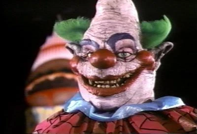

Previous in Forum: Running A 11KW 2 Pole Inverter Duty Motor At Low Speed   Next in Forum: Motor Connector
15 comments
Join Date: Dec 2014
Posts: 418
Optimum Binary Signal One Can Transmit on a 1 Hz Frequency
08/10/2015 12:32 PM
What could be the equation limiting data transmission per Hz? Would it be possible to surpass wave capacity? What's the reliability of transmission of data in reference to this?
Typically not a homework question.
"When I thought I exceeded to be wise but wisdom was far from me" -King Solomon
Pathfinder Tags: Optimum bit in a Hz
Re: Optimum binary signal one can transmit on a 1 Hz frequency
08/10/2015 12:35 PM
Claude Shannon would certainly be able to shed some light on this subject. I suggest looking at some of his writings.
Hobbies - CNC - New Member
Location: Lost Wages Nevada
Posts: 1578
Re: Optimum binary signal one can transmit on a 1 Hz frequency
08/10/2015 12:39 PM
Kulas,
Why are you posing these types of questions here. You're smart enough to search the internet first... RIGHT???
Google search - "What's could be the equation limiting data transmission per Hz" - About 3,140,000 results (0.70 seconds)
Join Date: Dec 2014
Posts: 418
Re: Optimum binary signal one can transmit on a 1 Hz frequency
08/10/2015 12:46 PM
It's because...Hansel and Grettel did left a pinch of bread on the tracks in the forest but the birds did eat it, and so they were lost. But they did a smart choice, they ask the fox.--Is it not little red riding hood story?
Nah, it's because some of you here have been there already and I was just looking for the gates from all the bushes.
"When I thought I exceeded to be wise but wisdom was far from me" -King Solomon
Re: Optimum binary signal one can transmit on a 1 Hz frequency
08/10/2015 12:54 PM
What does Bill Gates and George Bush have to do with all this?
Join Date: Dec 2014
Posts: 418
Re: Optimum binary signal one can transmit on a 1 Hz frequency
08/10/2015 12:56 PM
"When I thought I exceeded to be wise but wisdom was far from me" -King Solomon
Hobbies - CNC - New Member
Location: Lost Wages Nevada
Posts: 1578
Re: Optimum binary signal one can transmit on a 1 Hz frequency
08/10/2015 1:08 PM
Re: Optimum binary signal one can transmit on a 1 Hz frequency
08/10/2015 1:14 PM
I'm partial to insane clowns myself. By nature they are so much less predictable.
Re: Optimum binary signal one can transmit on a 1 Hz frequency
08/10/2015 10:03 PM
Re: Optimum Binary Signal One Can Transmit on a 1 Hz Frequency
08/10/2015 1:21 PM
Re: Optimum Binary Signal One Can Transmit on a 1 Hz Frequency
08/10/2015 10:08 PM
"Considering all possible multi-level and multi-phase encoding techniques, the Shannon-Hartley theorem states the channel capacity C, meaning the theoretical tightest upper bound on the information rate (excluding error correcting codes) of clean (or arbitrarily low bit error rate) data that can be sent with a given average signal power S through an analog communication channel subject to additive white Gaussian noise of power N, is:
where
C is the channel capacity in bits per second;
B is the bandwidth of the channel in hertz (passband bandwidth in case of a modulated signal);
S is the average received signal power over the bandwidth (in case of a modulated signal, often denoted C, i.e. modulated carrier), measured in watts (or volts squared);
N is the average noise or interference power over the bandwidth, measured in watts (or volts squared); and
S/N is the signal-to-noise ratio (SNR) or the carrier-to-noise ratio (CNR) of the communication signal to the Gaussian noise interference expressed as a linear power ratio (not as logarithmic decibels)."
https://en.wikipedia.org/wiki/Shannon%E2%80%93Hartley_theorem
https://en.wikipedia.org/wiki/Symbol_rate
https://en.wikipedia.org/wiki/Nyquist_rate
Posts: 1217
Re: Optimum Binary Signal One Can Transmit on a 1 Hz Frequency
08/11/2015 12:23 AM
So, the answer is 42?
Join Date: Dec 2014
Posts: 418
Re: Optimum Binary Signal One Can Transmit on a 1 Hz Frequency
08/11/2015 8:55 AM
Wow, say B=1 & S/N=1 or SNR typical.
C= 1 log2 (2) = 1 bit per second/1Hz. Nice, what if the wave is still modulated?
Anyhow what's the usual SNR? I mean range, @ normal conditions?
"When I thought I exceeded to be wise but wisdom was far from me" -King Solomon
Posts: 4533
Re: Optimum Binary Signal One Can Transmit on a 1 Hz Frequency
08/11/2015 11:01 AM
Why are you people responding to a question that is jibberish?
"Typically not a homework question. "
What about this time?
Join Date: Oct 2007
Location: Sour Lake, TX 30°08'59.68"N 94°19'42.81"W
Posts: 675
Re: Optimum Binary Signal One Can Transmit on a 1 Hz Frequency
08/11/2015 1:25 PM
Once upon a time....
A rookie electronics engineer had to answer the question: how much information can you send on a marine band (some 4 MHz carrier) if you are constricted to 10 channels, each of 300 Hz bandwidth. He was full of...confidence, and answered that 300 Hz bandwidth will limit very much. There was this mid aged EE who told him that, if not constrained by time, and if he has enough precise transmitting and receiving devices, he can cast as much information he wanted. It is the rate of change of one of the three (amplitude, frequency or phase) that limits (talking ideal situations with no noise).
But that was a long, long time ago....
Bridge rule #1: Nobody is as good as he thinks about himself nor as dumb, as his partner thinks...
Re: Optimum Binary Signal One Can Transmit on a 1 Hz Frequency
08/14/2015 11:27 AM
"10 channels, each of 300 Hz bandwidth"
You could send quite a lot. You could even have a secured communication, breaking the data up so each 8-bit byte gets spread across eight channels, with one channel sending the 'interleave' key for that packet(1) and one channel sending gibberish to confound hacking attempts.
Or am I getting too clever for the NSA's good? (Like you guys haven't seen that before, having fun reading everyone's e-mail, Agent? If you still have some air-sick bags to fill up, I could find the REALLY weird stuff to e-mail to myself.)(2)
Notes:
  1. Say Interleave code 0x07 = 35296418 Yes, the 'gibberish channel' changes for every packet.
  2. The way the NSA's been snooping, you don't think they're watching this forum as well?
Register to Reply 15 comments
adreasler (1); Brave Sir Robin (2); Deefburger (1); indel (1); Kulas (3); lyn (1); Original_Macgyver (2); SolarEagle (2); StandardsGuy (1); tcmtech (1)
Previous in Forum: Running A 11KW 2 Pole Inverter Duty Motor At Low Speed   Next in Forum: Motor Connector
