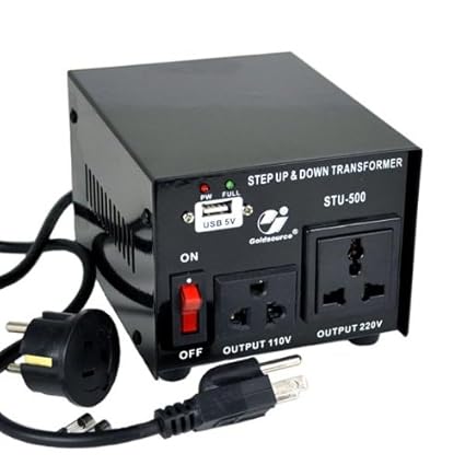

please i need professional advice about my voltage converter. it has a switch that lets u step down 220v to 110v and step up 110v to 220v. the problem is i plugged it on a 220v outlet while the switch is at 110. the voltage converter created a smoke and smells aweful. i opened it and saw burnt plastics around its copper coil. please any advice if i can still fix it. thanks.
Pathfinder Tags: voltage converter burned
Re: voltage converter burned
08/29/2015 3:14 PM
Don't do that again, if when you buy a new one.
You fed 220V into the 110V coil and released the magic smoke.
Recycle the stinky one and BE CAREFUL next time.

If you can find a replacement transformer (and that's a big IF), and if you haven't destroyed any other components such as switches, contacts or wiring, and if you know how to solder and can replace any parts that you have destroyed, and if it works properly when you have repaired it (another big IF), and if it doesn't still stink like a burned up mess, and IF you are honest with the person who loaned it to you, maybe.
You should buy the poor soul who loaned it to you a new one!
Then, if you are capable, you can repair the one YOU destroyed for yourself.
Do you have a DVM? Soldering Iron and solder/flux? Any experience?

Theoretically yes you can repair it if you have a full list of the exact parts needed, a source where they cost less than a new unit and the necessary hardware skills to keep replacing parts till it works,
I have the skills (as many do here!) but I would not waste my time. Remember, it will still be a repaired unit with parts that have already suffered over voltage at the end of the day, but with possible - Reliability = ZERO.
Bite the bullet and buy a new one.....simply be more careful and always store it with the higher input voltage selected, so usually no damage done if you forget again....simple.

Next time put an input fuse especially at 110V taping. Check the txr insulation, If it is ok clean it and try to varnish it again. If there is an insulation failure get it rewind. Idont think the other components like switches have an issue. However check the contact resistance and wiring.

Probably not as the current at 110V operation is double the current required for 220V operation which means the fuse would never be able to interrupt the circuit before severe damage occurs. (Inverter Power In = Inverter Power Out)
This is a classic case of equipment insulation damage from applying too high of voltage.
Some units have componentized circuitry in which the power supply can be replaced as a whole unit.
If the unit in question is of such assembly a call to the OEM might offer more cost efficient options.
If there is a competent electronic repair facility in the area the OP should be able to take the unit in for obtaining a repair estimate and warranty details.
This would yield a better way of deciding the best option of whether to repair or replace the unit.
In my opinion scrapping it and buying a new one is the best option especially since this can impact the OP's relationship with their friend.

The acrid smell is that of the burning insulation of the wiring, likely the coil windings of the internal transformer. As mentioned in theory one could find and replace that transformer, but there is no guarantee that this is the ONLY damage, so you might (likely) find the next failed component only AFTER you replace that, which might reveal the next one, then the next one, ad nauseum. So by the time you spend countless hours and treasure on this project, you will still end up so deep in the hole compared to just buying a replacement, that suicide will appear to be a viable option. Yet your friend will still not have a working converter, PLUS he now has to live with the guilt of having been party to your demise and feel responsible for supporting your survivors.
Do a favor to both of you and replace it now.
