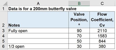

Does anybody know a way of interpolating from a list of numbers in XL?
E.g. I have Kv (or Cv in US) figures for a butterfly valve given for disc angles 0°, 10° …..90°. I would like to enter an angle and get corresponding Kv, either linearly interpolated, or better still from a smoothed curve. Or the other way round. XL can do a plot of the data, showing either straight or smoothed lines, so the information must be in there somewhere.

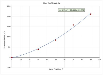

Location: PA, USA
Posts: 81
Re: XL Functions
11/18/2015 12:10 AM
Typically I've used some add-in cubic spline functions to smooth and obtain interpolated results. SRS1 Cubic Spline is one case that I remember.

Location: PA, USA
Posts: 81
Re: XL Functions
11/18/2015 9:54 AM
EXAMPLE OF CUBIC SPLINE (not sure whether inserted image will show up):
"For a successful technology, reality must take precedence over public relations, for nature cannot be fooled." -Richard Feynman
Re: XL Functions
11/18/2015 9:57 AM
did you insert it?(using the camera icon), or did you paste it.
Location: PA, USA
Posts: 81
Re: XL Functions
11/18/2015 4:32 PM
First I tried simply pasting a *.png image file.
Then I tried the camera icon, browsing to a *.jpg file.
Neither showed up in the preview, nor in the actual posting.
At any rate the add-in has a Bessel, Cubic, Linear, and One-Way spline functions. In the simple test the Bessel and One-Way were the same. The non-lineary splines looked more reasonable.
Perhaps one could take the actual tabulated data, leave out every other value, and then see which spline does the best job of duplicating the skipped data.
