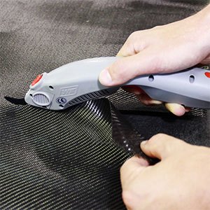

I would try something like this...
You would have to experiment with how many layers you could cut at a time, and how fast to change the blades, and what type of blades you might acquire or find or design...A solid diamond blade edge would be desired...A blade sharpener built in would help......A jig for holding the fabric, that would allow you to work off the edge and turn...
http://www.ebay.com.au/itm/Handheld-Electric-Cutter-Scissors-Shears-Fabric-Cloth-Leather-Carpet-10cm-Blade-/151315877198
