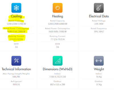

Hi all (including Lyn):
It is killing hot now. i am running a 1.5Ton split non inverter air conditioner which is taking 9 ampere current. the unit electricity cost is $0.15/unit. the A.C runs for nearly 14 hours of the day. with 9A running for 14 hours a day , the bill is too much for me and my pockets are drying up. now i want to replace this A.C with a 1.5Ton DC inverter A.C . the specs of the DC inverter A.C are " Cooling Ampere= 7.2 A (2.5-9.7A) " . I cannot understand it. what is 7.2A and what is the range of 2.5A-9.7A. ? Will i be able to save my electricity billing by installing this DC inverter AC?
Re: Electricity billing of DC inverter A.C
06/05/2016 11:23 AM
The bottom line for efficiency is the EER or energy efficiency rating....how many btu's you get per watt of electricity....so an 18k btu unit drawing 9 amps@ 230v is using 2070 watts of power 18,000/2070 = 8.7 EER....You should be looking for something in the 14 or higher EER range...
Join Date: Jul 2011
Posts: 286
06/05/2016 12:02 PM
never saw an EER of 14. Are you sure about about your calculation.? below is the technical specs of the A.C i want to purchase. i just want to know the current range of
2.5 to 9.7A.
06/05/2016 12:36 PM
Obviously this is a variable load unit....2200 watts to 5700 watts...
"A net refrigeration effect of nominal 18,000 Btu will be 5270 watts.
This EER is 5270/ 1950 = 2.7 It is also called (COP) coefficient of performance. One estimating rule of thumb is that an air -cooled unit compressor and fan will draw about 1.2 KW per ton of refrigeration. That is a COP of 2.8 "
They take a median estimate at rated capacity 5200 watts 1640 rated power consumption 7.1 amps power draw with a 3.6 COP....
There are different ways to measure the efficiency...Now if you look at the 18,000 btu's at 7.1 amps * 230 volts is about 1640 watts divided into 18,000 btu's is about an 11 EER....

The answer is, a definite maybe, since as usual you have not given enough data to make an informed decision. Things like indoor and outdoor ambient conditions play a large part in how much comfort an a/c can provide, and when they're coupled with the highly variable response to what/how different people feel under identical conditions, it's even more difficult.
On the other hand, if you're current unit's compressor is running all the time and it's still too hot/humid for you, an identically sized inverter unit may actually cost you more to run under the same circumstances. Here's what those numbers mean; 7.2A is the average draw under rated test conditions, so you save 20% over the 9A your current draws at the same conditions. The "gotcha" comes from the other numbers; the 2.5A is the unit running under lower temperature/humidity conditions when just the fan is running, the 9.7A is the draw when both the fan and the compressor are running constantly and you're tapping into the unit's reserve capacity.
Only you know what your operating conditions are, but if I were you my choices would be to raise the thermostat, reduce the heat gain, move the unit to a place out of direct sunlight, and lastly replace the unit when it finally quits from overwork.

" the specs of the DC inverter A.C are " Cooling Ampere= 7.2 A (2.5-9.7A) " . I cannot understand it. what is 7.2A and what is the range of 2.5A-9.7A. ? " The entire purpose of the inverter in the A.C. package is for variable speed control of the compressor/fan. If the speed is variable, the amperage draw will also change, hence the range given of amp draw, and an average number also given.
"Will i be able to save my electricity billing by installing this DC inverter AC?" I would say probably not. Not enough to make it pay for the new A.C. package, especially if you have done nothing to slow down or reduce the heat load of your house.
