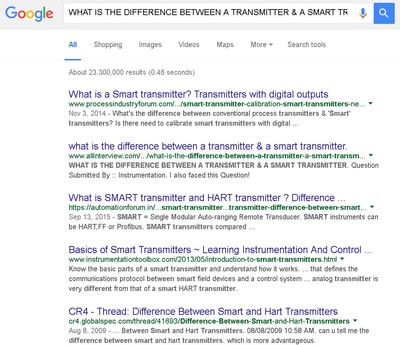

Why didn't you just input this into Google or some other search engine?:
WHAT IS THE DIFFERENCE BETWEEN A TRANSMITTER & A SMART TRANSMITTER?
If you did, you would get this:
Just look at all those hits!
In this age of information, it's better to input your query to a search engine. That will direct you to a specific answer and save time.
Welcome to CR4. Stick around and learn how better to frame questions. Don't be lazy. The more detail you supply, the better the answer will be.
