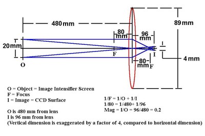

Sorry I didn't follow up sooner with a 2nd reply. I've had internet connection problems.
I've diagrammed a solution for you that uses only the 80 mm fl lens you have. It takes the 20mm high image from the Image Intensifier Screen and re-images it onto the CCD camera surface with a new image height of 4 mm. This gives you a 'magnification' of 0.2. A magnification of 0.2 requires that the object distance be 5X the image distance. So O = 5I. When this information is plugged into the simple lens formula, 1/ F= 1/O + 1/ I, where F = 80 mm, the solution obtained is I = 96 mm and O = 480 mm.
Please be aware that lenses have abberations affecting sharpness such as image flatness, pincushion or barrel distortion, and coma. So the lens you have will produce an image as I've shown, but whether that image is a high quality image depends on the quality of the lens for this particular purpose. (You might even get some color fringing if the phosphor in the Image Inensifier Screen has a broad band spectrum.)
Here's the sketch:

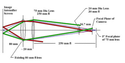

If you add a large (75mm dia), long focal length (~250 mm) lens behind your existing 80 mm fl lens, then use a 30 mm lens to create the final image, your net throughput should be significantly better. And this should give you the image 'magnification' you want.
Re: Lens Optics Problem
07/12/2016 2:02 PM
Your 25 mm fl lens (which apparently has a diameter of about 18 mm) should work about as well as the 20 mm dia lens I show. Your net magnification would be about 0.28, which is close to what you want.
There are other ways to approach this. This is a simple example. The key, as I see it, is to place a 2nd lens behind your 80 mm lens, as I show in my sketch.

I have redrawn this diagram to illustrate the futility of this whole exercise. Some of the light from the off-axis object misses the final lens, and some of it even misses the middle. The final lens, placed as it is at a distance close to its focal length from the sensor, achieves very little in the way of shortening the optical path and diminishes the light-gathering power. If it can be removed from the optical path and replaced by a large intermediate lens, as suggested by Usbport but with a shorter focal length alone, so much the better.
