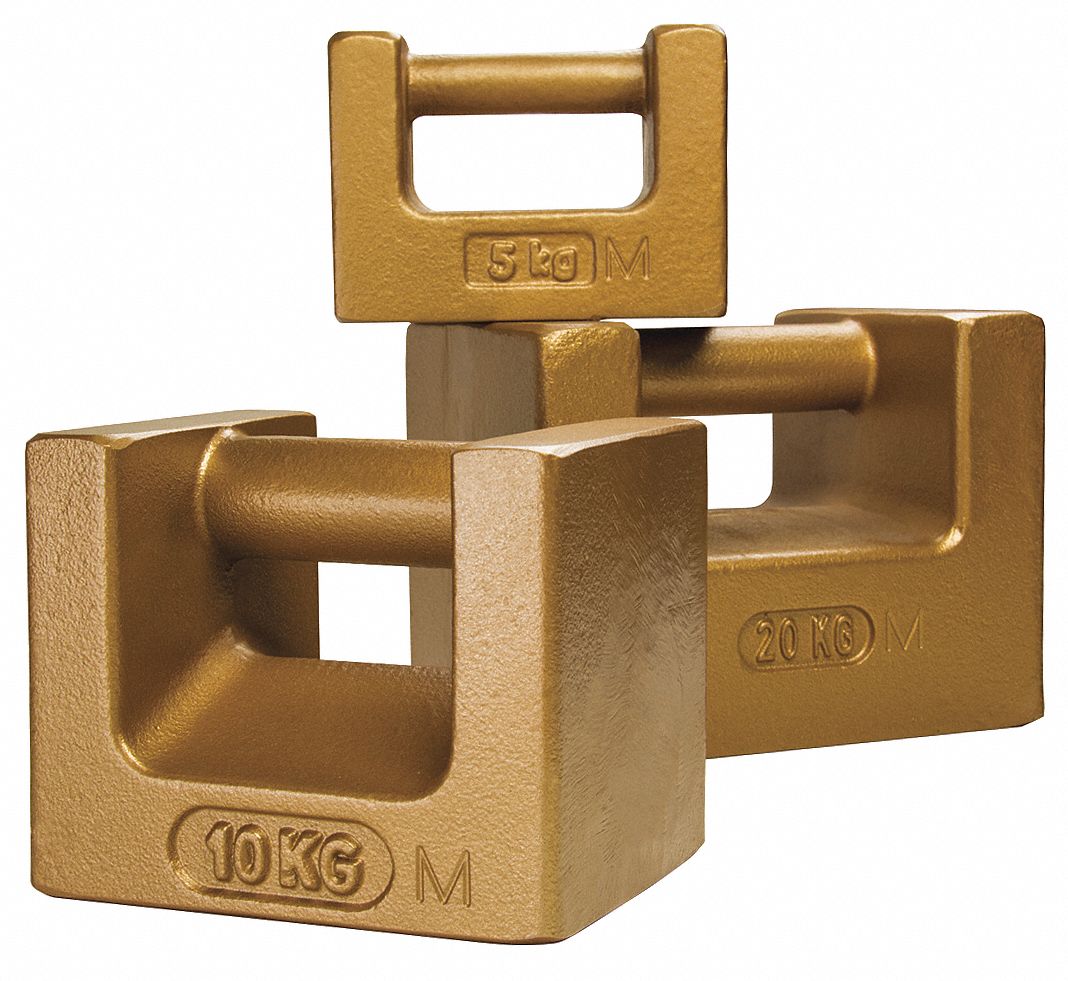

I have 2 weight scales (one electronic strain gauge scale and one a spring scale) each rated at accurate to +/- 2% of FS weight and both have the same FS range. I am measuring an unknown weight within the ranges of the scales. The values agree within the 2% difference. Is the best way to estimate the value of the unknown weight just to use the average of the 2 values ?
Re: Scale Accuracies
08/25/2016 10:51 PM
No the best way is to check the calibration of each scale with test weights....
https://www.grainger.com/category/calibration-weights/scales-and-scale-accessories/material-handling/ecatalog/N-loy
Reply Good Answer (Score 4)
