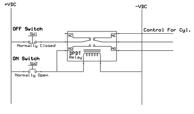

Here is a crude drawing of how it can be done. Sorry I don't have a drawing program on this computer.

Here is a drawing of a relay latch circuit. When Sw1 is closed, the relay energizes and holds itself energized through the contacts CT1. When Sw2 is opened, the relay releases.
If my understanding of your circuit is correct, you need two of these latches. One is for the Start and Stop buttons. When you push the Start button (Sw1), the circuit has to stay energized until you push the Stop button (Sw2). This latch powers the rest of the circuit (the second latch, hydraulic solenoid, and limit switches) from the hot side of the relay.
The second latch is for the limit switches. (I am assuming that the limit switches are momentary acting.)
For the sake of argument, I am assuming that an energized solenoid directs the cylinder to the right, and de-energized to the left. In this case, the normally open contacts of the left limit switch would be Sw1. When the cylinder is full left, Sw1 closes momentarily energizing the hydraulic solenoid and the relay (which remains latched), and the cylinder moves to the right.
When the cylinder reaches the right limit switch, Sw2, the normally closed contacts open and break the circuit to the relay and solenoid. The solenoid is now de-energized and the cylinder moves to the left.
I hope this helps.

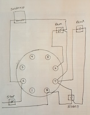

Presuming that de energized is the retracted position,put the retracted limit switch in parallel with the start switch,and the extended limit switch in series with the stop switch.
When the cylinder extends,it will break the latch circuit,causing the cylinder to retract.
When it hits the retract switch, it will re-energize the start/latch circuit.
Use one set of contacts to latch the relay,and the other set to energize the coil in the extended position.
Remember: All start switches in parallel,all stop switches in series.
Sorry,no schematic,but I hope my explanation is sufficient.

If you require "no volt protection" then what you want to do can't be achieved with just one relay.
If, however you don't need no volt protection, then replace the on/off push buttons with a simple SPST switch, and it can then be done with one relay.
The attached circuit should assist.

A slightly revised version of my first circuit that disconnects supply from both sides of solenoid when switch is off.
If the solenoid should require a reversed polarity to the proximity switches, then simply move the On/off switch to the other supply leg as shown below

I am overwhelmed by the responses, thank you all. In answer to your questions.... The prox switches are momentary. The hydraulic solenoid requires energizing on both forward and reverse cycles. The momentary starting switch is not a must, but it does need a stop switch.

There are two coils on the solenoid valve, one for in stroke, one for out stroke

Then simply fit a latching emergency stop button in series with the on/off switch in my circuit
