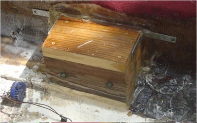

This boat has a small surface crack on the inside part of the transom, on the hull wall opposite of where a 6 HP outboard is mounted and exerts force.
These images make the crack seem large or like it's pulling away from the wall, but that's just an effect of the flash and image angle. It's been ran the past 3 seasons with the crack and no resultant leaks. I'm conducting this 'fix' for peace of mind.
The boat manufacturer recommends a 2-6 HP engine, but there was formerly a 10 HP outboard mounted, which caused this crack. On the outside, the hull and jackplate mounting in this area are 100%.
My thoughts were to marine epoxy the crack, and make a wooden or metal brace that should help distribute the force over a larger surface area. This brace could be fiberglassed in too, but I want to be able to remove it should I need to service this area in the future.
Structural reinforcement is most important spec here. You can ignore the wires as they'll be rerouted soon. This fix may see the occasional splash of gasoline or water.
What do the resident experts of CR4 recommend? I can supply more info/pics as requested.

The outer hull looks good. but if you took off the bracket, you may be surprised.
Just keep in mind, when you put reinforcement in, depending how you transfer these forces, the force has to go somewhere. try to transfer it over a larger area.
I mean not just enforcement, but at the end of the reinforcement.
I know of people who did this, and then there where cracks around the reinforcement.
Plus you don't want to add too much, where you have a lot of weight in the transom.
When I had my shop, I had a customer that wanted to put a 6' swim platform behind his boat. (Big boat)
When he was explaining what he wanted, the weight was just adding up. I did convince him of putting a smaller 4' platform on. I told him even then you'll need trim to keep it level, plus I'm sure there's going to be other surprises.
All was pretty good... I guess, I did see him at the end of the summer and I ask him about it. he did say there was just one issue. I asked him what it was, and he said when he stopped quick, the wake came in and washed through the boat.

Thanks. The hull is not cored, so there shouldn't be rot or delamination. It's complete 1970 fiberglass! I will replace the hardware when I do this in a few weeks, and metal brackets would certainly be lighter.
"I mean not just enforcement, but at the end of the reinforcement."
Could you explain further?
HUSH
Re: Transom Reinforcement
10/05/2016 10:16 AM
ahhhh... this is from hindsight that I'll share with you.
When I worked at the shipyard, a friend of mine had an older boat. and he was putting on a larger motor on it... a really larger motor. This guy was pretty knowledgable, he actually repaired props as a sideline job.
We were teasing him that that'll tear the transom off. so he reinforced it where the motor mounted.
Well from what I understood, it cracked around his reinforcement. If he would have reinforce the transom all the way to the port and starboard side, it may have worked out. But it was a small boat, so he didn't have much to work with and the motor was way over sized. The side probably would have cracked. I wish it was filmed.
With yours, it may not be too much of a problem, your going back to a smaller motor, and even though there may be a question with integrity. it's nothing that gelcoat and fiberglass can't repair. But something's, when you dig in, one finds surprises. In his case, it turned out the plywood was rotten.

One thing you can't see is the condition of the plywood interior....it could be rotten....I would grind down the crack to see how deep it goes and check condition of wood interior section...Once the crack is ground down to the wood you can refiberglass the damaged area, or if the wood is rotten, replace the transom....

I think he means.
If you add a reinforcement that is too solid, or ends too abruptly, you will just move the stress to the edge of the reinforcement.
If it was me I'd add extra layers of glass mat, but fading it out over a large area. E.g 3 layers over the existing area, 2 layers going out another 6" and then 1 layer going out another few inches beyond that.

I like this better than a mechanical brace actually. I can still epoxy the crack and then add fiberglass over it. I can certainly do that along the right and bottom edges of the crack, but you can see along the left crack area it is impossible to reach farther than few inches.

This looks like it is pushed in at the bottom....I think I might consider adding a brace at the bottom....

Usual disclaimer - I am not an engineer. What I see, though, is a motor mount applying a force to the centre of a flat plate, the transom. That force is then transmitted to the sides of the vessel via the edges of that flat plate. If you propose a brace, I propose at least two braces, extending the full width of the transom.

Remove all the gel coat with a disk sander and get down to the bare glass fibers, so the resin/epoxy can impregnate that as well.
I'd also use glass mat/woven roving instead of just cloth.
The choice of plates is up to you, but stress distribution is the goal.

Indeed. It's tough to a get a grinder or disk sander down into the area, so an orbital will hopefully do. I don't expect gelcoat on this side of the hull.
Once I get more area exposed and can judge the the depth of the crack a little better, I will consider some bracing hardware. If it is just surface cracking, like I expect (and hope, lol), then some cloth and a few layers of epoxy and hardener should do.

Please.... do not use epoxy until you know what the actual base plastic is. Is it poly, vinyl, epoxy or other?

At the risk of creating another "I know more than you do" controversy, it is a pretty good bet that the boat is built using "glass" fiber and polyester resin. Determining the type of glass would require a lab analysis. Carbon (black) or Kevlar (yellow) is only used in high performance boats, which this is not.
While polyester resin would be the same family as the parent resin, and fine for the job, I don't think marine epoxy would be a bad choice as a patch.
While I defer to your boat building prowess, I spent many years as a materials engineer with an aerospace/military electronics manufacturer.
Hush should continue as he has planned.

I would be willing to bet a princely sum that it is a polyester resin with regular old 'glass' as well. I've been around boats my entire life as my parents were avid sailors.
I would do some light grinding to get down to 'virgin' material free of paint, dirt and oxidized resins, clean it really well and that way the solvents in the repair resin can help create solvent welds between the old resin and the new.

I agree with what the others have said, but I'd add two small comments. 1. Be sure to round-off the corners of whatever reinforcement you use. Sharp corners are stress risers, so you want to avoid sharp corners. And 2. You might want to add some vibration-damping grommets under the motor mount surfaces. You can google the term to find what kind would work best.

From the engine size and picture of the transom I am going to guess this is a sailboat under 20ft?
Don't forget to check where the transom attaches to the sides and bottom for cracks, if there are stress cracks at the motor mount there might be some at the edges too. Although I would guess from the pictures that the boat impacted a pier or something with the engine. It just looks like a shunt as opposed to fatigue.

My advice would be to enlarge the outside surface area of the mount,perhaps even doubling the length of the mount to,distribute the forces,and as noted elsewhere,use rounded corners at all contact points.
Sharp points and corners amplify forces,aka:stress risers.
If you simply repair the existing area,you will still be applying your load to an existing flexible area,which could create stress risers within the old fault lines,unless you grind the fault lines out totally.
If you don't get rid of the old cracks,or use the same size mount,there will always be a weak spot.
Of course,you could simply pile multiple layers of fiberglass mat and epoxy and hope for the best.
However,the ocean is not a good place to discover your mistakes.
Also,I agree with adding vibration mounts to the motor,as mentioned by others.
This is in addition to the inside reinforcements recommended by others.

Just did this to my 22' Power cat, with two 150 hp outboards. We needed to put on jackplates and set the engines back, in order to move the Center of Gravity aft, and to be able to raise or lower the props for various activities. What was used was a 1/4" 316 stainless plate on the aft side , and two 4 inch wide stainless plates (straps) on the inside of the transoms, running as far past the mounting holes as we could run them. As mentioned , the transom was repaired first, where necessary, then plated. The plates are now removable if need be, and all is visible, for inspection. I glassed boats for years, and unless done with care, you could be covering up a lot of potential problems by just throwing on a few layers of glass. Also, if possible, add a shear plate under the deck (if there is one at that point), to transfer the transom load as far forward as possible. Just another approach.

The thing I am not seeing is exactly how the motor mount is constructed.
1. Are there 4 studs attached to a large metal plate that is sandwiched between layers of fiberglass ?
