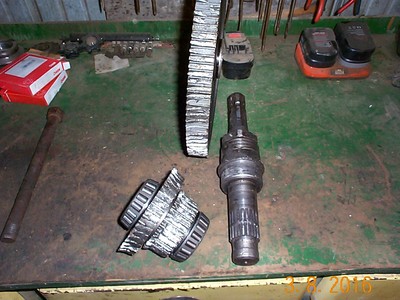

Back when I went to tech college in the mid 90's we lowly students in machining lab classes were knocking out custom made gear sets for antique equipment with sub .001" tolerances with ease on non CNC based lathes and milling machines.
Local farmers and the like would bring us old worn out gears from whatever machines they had and we would replicate brand new ones made to crazy unnecessarily tight tolerances just to get a good grade on our lab work. OEM design may have been +-.020" but we made the new ones to +-.0005 or better just to put the tolerances below what the instructors measuring tools could accurately check without being a lot of extra work for him.

10/27/2016 9:33 PM
I know! that was the whole point. Make the lab project to such tight tolerances that it fell way below the minimum repeatable accuracy of the hand held measuring devices the lab instructors used!
If the specs sheet called for +- .003" aim for +-.0003 " being that doing any accurate measurements below .001" are rather hard to do quickly and accurately on a semi complex machined part.
In all reality though once the gears we cut got installed in the old machines they were designed for I have doubts anyone of them had much under +- .01" tolerances at best once they were properly worn in.
Precision gears on sloppy old worn shafts held in place by sloppy old worn out bearings and bushings tend to take on a lot of tolerance losses as they wear in to match everything else. Especially if the gear it had to mesh with looked like it was lubricated with gravel for the last half of its life.
PTO gear set from our old MF 2745 that got wiped out last summer and a typical representation of what we got way back then in machining labs as the projects we had to replicate.

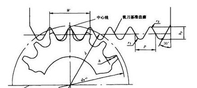

10/20/2016 9:47 PM
The equivalent of 6.35 mm is 0.25"; various chains may be designated xx25. Most any drive chain supplier's catalog should have what you want.

10/20/2016 10:05 PM
I can design the sprockets for roller chain, but I do not have a understanding or data to design the tooth form for the inverted tooth chain ... the main reason for wanting to use inverted chain was the small pitch and not the roller chain because of chordal speed variation when using sprockets below 25 teeth.
I have lots information about the inverted chain shape but not the sprocket shape to engage with it.

Web search "timing chain sprocket profile"; get gazillions of results.
Posts: 34
Re: Timing Chain
10/20/2016 11:50 PM
Try inverted tooth chain sprocket ... ordainary timing chain no problem ... the din standard only goes down to 9.525 mm and does not show 6.35 mm
Batt
Re: Timing Chain
10/20/2016 11:57 PM
Then use a scale factor of 2/3. Or just go to 3/8" chain.

There are a lot of patents on google which are supossed improvment on the 60 deg flat flank inverted tooth chain but I would be wary of using any of the data attached.
Have corresponded with IWIS but they do not reply to queries.
The ramsey and morse chains are what are called rolling pin joints which are made from two parts which fit a special shaped hole in the link and are generally called hy-vo which are used for transmission.
The inverted tooth chain for timing engines has a solid round pin and is called a silent chain.

The chain from manufactures I have seen has a included angle of 60 deg

Tsubaki makes 6.35 and 8 mm pitch silent chain. Their site shows guides and sprockets. If they can't supply them, surely they could provide the information to design them. Or is this one of the companies that won't talk to you?
