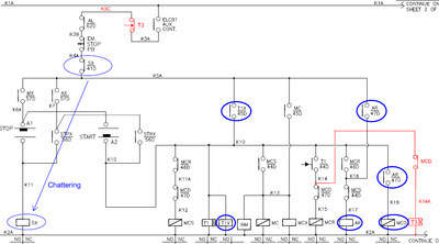

Re: Relays and Contactors in Control Circuit
11/24/2016 6:15 AM
Hi JRaef,
This is actually regarding closed transition star delta starter finding the cause after the delta contactor's wires got burnt.
Assumption:
Even if MC(Main Contactor) is OFF, the motor keeps running in star connection through the capacitor in case of "MCD" (Delta Contactor) ON.

The aux. relay "SX" makes chattering when STOP signal given. There may be possibility that aux. relays "T1X" and "AR" keep ON and contactor "MC" turns OFF during chattering due to different sensitivity between relays and contactors as above. "MCD" keeps ON if "T1X" and "AR" keep ON during chattering and afterwards.
The motor needs higher current to give enough torque with star connection. Due to wrong setting of the motor protection relay (MPR), the motor runs continuously with higher current for some time. This higher current causes damage "MCD" and burn wires connecting "MCD".
Then after some time, MPR is activated and "T1X" and "AR" are turned OFF.
When contacts of "MCD" mechanically stuck due to higher current, the motor never starts again even if START signal gives because auxiliary contact "b" of "MCD" never turns ON.
Power Circuit:
Control Circuit:

11/24/2016 9:44 AM
Main motor circuit readable.
Control circuit - impossible to read vital coil & contact codes.
Initial thought - contact under "EM STOP" if on SX or any relay /contactor of control circuit will "cut its own throat" and cause chattering.
Chattering will overstress contactors & cause contact welding, leaving motor running.
You may have a drawing error giving faulty circuit or a wiring error (not to circuit) or a contact which is not working in addition to welded ones. Maybe this panel is new and was not tested.
Can do no more until coil/contact codes readable.
Cut control circuit into two halves & make two pictures which are readeable?

Hi 67model,
Thank you!
Here is the drawing cut in to halves.
Posts: 1686
Good Answers: 116
11/24/2016 12:38 PM
Diagram good, thankyou. But many contacts, like MX & AX must have coil on sheet 2.
The SX contact which "cuts SX's throat" must be wrong, maybe there should be a contact, but the wrong code (SX) was put on diagram.
Timer T3 appears to be "end of stop sequence" which drops everything. Be warned that not every type of timer has a "slow drop-out" to suit this function (everything else must have de-energised before T3 releases else T3 might re-energise, depending on circuit) [suitable T3 would usually have a large integral capacitor, to keep it energised or might be pneumatic/magnetic slug slow release].
Maybe contact STPX should be SX [to hold SX on after hand release of stop switch] and contact labelled SX should have been STPX?
Since do not have sheet 2, too much is missing to guess further.
67model

Where did this scheme come from? It appears to be a Closed Transition Star-Delta, but that requires a set of ballast resistors that are put in the circuit during the transition. I don't see those. In addition, the capacitors are on line all of the time, which will keep the stator magnetized continuously and that would have potentially disastrous consequences, especially during a closed transition from Star to Delta! This appears to me to be the work of someone who did not understand how Star-Delta closed transition starting is supposed to function. Either that or it is some odd scheme that I have never heard of and I looked around the internet for references to it, found nothing.
here is what a closed transition Star-Delta starter scheme is supposed to look like. Scroll to the bottom.
11/28/2016 5:31 AM
There may be more faults with this starter than the SX contact (see post #18). Once you get one fault, everything in the circuit must be checked and the wiring/contact types [N/O or N/C] since someone may have tried to fix problem quick and failed - so several things are now wrong.
As written, sheet 2 of control circuit has not been posted, so some of the contacts do not have coil on circuit posted or function explained.
Looking at control circuit, here seems to be an expectation that one contactor drops-out as fast as another picks-up.....hence question about operate/release times.
If you want help, post sheet 2 of control circuit.

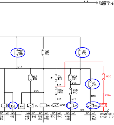

11/28/2016 5:48 AM
Hi 67model,
Thank you for your Interest, sheet 2 is attached below. by the way, I suppose timer (T3) is for fail safe operation, that is if the motor haven't switched to Delta after certain set time in T3, it will stop the motor.
Posts: 1686
Good Answers: 116
11/29/2016 5:46 AM
Thanks for page 2 --- MX, AX, STRX, STPX explained.
I think the mistake was that MX & AX contacts should have been wire K4A not K5A. See modification below.....
Sequence of START operation :-
Start demand energises wire K10.
Relay T1X energises and holds-in "run" command with its N/O contact K5A to K10. Simultaneously, Star contactor MCS begins to energise and delayed-on timer T1 begins to time.
MCS auxiliary N/O contact closes and energises Main Contactor MC coil from K10. N.B. main contacts of MCS may be a little slower than its auxiliary, but the operate time of MC ensures MCS is fully closed before MC main contacts close.Hours Meter HM and relay MCX energise in parallel with MC.
MC coil holds itself in with its N/O contact from K13 to K5A. MC main contacts energise motor windings, MCS main contacts having already connected them in star.
Motor runs up to part speed in time permitted by timer T1. T1 N/O contact energises coil of "resistor contactor" MCR. MCR main contacts connect discharge resistors in parallel with motor windings. MCR N/C auxiliary contact opens "Star Contactor" MCS coil circuit and its main contacts open after its "release" delay. The motor currents, which could sustain voltages opposite to re-applied line voltage die away with L/R time constant which is shorter due to added resistance N.B. thanks to resistors, MCS breaks resistive circuit rather than inductive.
MCR N/O auxiliary contact energises relay AR coil, provided MCS has released and its N/C contact has closed. AR coil holds-in via its N/O contact to K5A. Relay AR energise delay allows time for any overlap between MCS main and auxiliary contacts and arcing of MCS contacts before its N/O contact energises Delta contactor MCD coil - time to close MCD main contacts adds to the time for motor current to decay.
MCD N/C auxiliary contacts open both MCS and MCR contactor coil circuits, leaving the motor running in Delta with contactors MC & MCD energised.
Maybe the T3 alarm circuit could be improved.......
Remove T3 contact from K3 wire and put in K5A wire after SX contact.
Feed T3 coil from SX contact via ....
MC N/O..........................................|................... T3 N/O
MCD N/C................MCR N/O.....MCS N/O................|
() T3 coil
Please regard ..... as just space - CR4 removes spaces!! No time to draw & scan sketch.
T3 delay must exceed normal start time. Alarm will persist until STOP demand.
67model

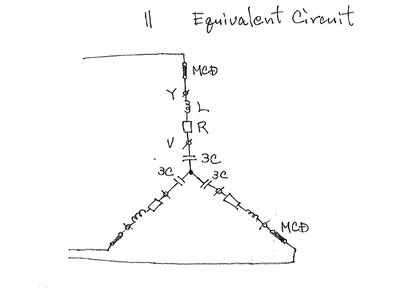

I tried to draw the circuit, if MC(Main Contactor) is OFF, the motor keeps running in star connection through the capacitor in case of "MCD" (Delta Contactor) ON. What do you think about this?
Posts: 1686
Good Answers: 116
11/29/2016 4:56 AM
Yes, motor runs.
11/30/2016 9:04 AM
OK! My last post was a quick reply. Running the motor through the capacitors might cause damage or not.
Firstly, the capacitors are rated for line voltage, continuous. So line/√3 in star is OK.
Second, supposing the motor runs via capacitors at normal shaft speed, because there is no great mechanical load when you "stopped" the motor - mavbe all the water runs out when it "stops" and windage is negligible.
The motor electrically is then just the magnetizing inductance, with rotor unloaded. However, the capacitor, in series resonance, will cancel part of this inductance, increasing current in winding and capacitor beyond that for line/√3 voltage - this is unlikely to overheat motor but capacitors could overcurrent.
If the motor has significant load and is in a "stalled" state, the rotor is like a shorted transformer secondary - causing 6 times full load current at rated winding voltage - maybe the reflected inductance & resonance cause excessive current in capacitor or motor, noting that if motor is running at reduced speed then cooling airflow may be reduced making temperature rise worse.
