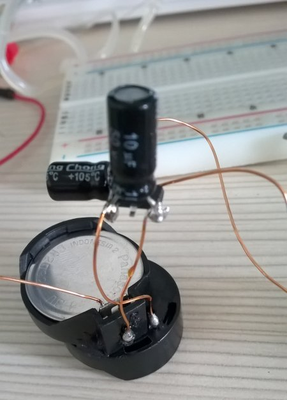

Power section:

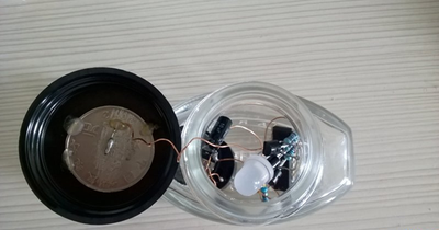

One coin as the touchpad: (This bottle of ink was presented by my friends, and now I intend to pay him a coin)LOL
Then loaded it in, the problem came with that.

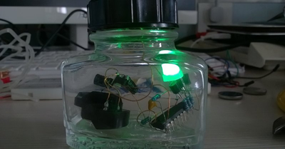

At first touch is not working, it can not be detected with any effort. Then it turns out to be touched with my finger contact with the positive side of the battery and then have a reaction. So I had to pull out a line; and then found that power consumption is not low. And soon it began to work out badly. Well, I have nothing to do with that but had to change a new battery. Show you some photos:
Red:
green
blue
purple
430 MCLK and SMCLK set to DCO = 16MHz, ACLK = VLO = 12KHz, with the timer TA1 three capture parity module CCR0-CCR2 generated three PWM control RGB, CCR0 interrupt frequency of 30 * 100 = 3KHz; CCR1 interrupt frequency of 100Hz, determines the PWM frequency, where the minimum 60Hz will not have a significant flicker; CCR2 interrupt frequency determines the transition time, depending on the need, here is about 20Hz.
MSP430G2553 each IO pin has a shock function, you can easily achieve capacitive touch, as long as a capacitor on it, but need to occupied TA0 and WatchDog, so here can not use the hardware PWM.
Found that this thing is not low power consumption. though it wake up every 5-6ms each time, but CR2032 voltage brush down, it is estimated that a large number of batteries should be prepared to do this.
