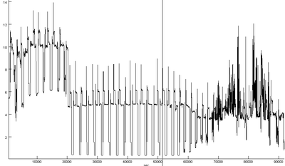

This is import to one phase in a real building over one day, loads are central heating pump, fridge ~ 2 amp, freeezer ~ 5 amp, lights ~ 0-8 amp and solar power generation (the fuzzy bits, logging cannot show power direction). Vertical amps, horizontal seconds 0 - 90000.
