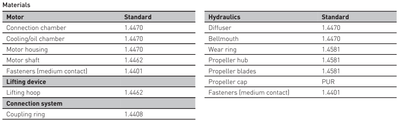

DIN 1.4470 is used for Motor housing. . Is this appropriate?

This question is related to the Foucault current in the motor housing.
"Appreciably magnetic" was quoted from the EN 10213 standard

But, The problem to be solved in "Material is Used in Wastewater" is: When submerged in wastewater, DIN 1.4470 has corroded or not. (field of metal corrosion)
The problem to be solved in the "Motor housing 1.4470 vs DIN" is:
Foucault current exists in the motor housing or not (which I think it exists).
If it exists, the engine would overheat (field of electromagnetic)

Then the real question is why do you care? The field is usually something that the motor designers worry about in an effort to minimize the overall losses of the machine. End users would only be concerned if there were any equipment that could be disturbed by the external magnetic field.

Eddy currents are everywhere, the problem you are trying to create is whether in this particular case they are large enough to cause excess heating. Why don't you prove by calculation that they will cause a problem since I seriously doubt a competent designer would do such a thing (although stuff happens).

Foucault currents (also called Eddy currents).
Foucault currents exist in the steel core (rotor and stator) of the engine.
This current heats the steel core and losses generated in the motor.
To minimize this current, steel core (rotor and stator) made from ferromagnetic steel sheets (thin) and stitch them together.
Between the steel sheets is an insulating layer.
In the case of using magnetic materials (eg DIN 1.4470 or iron), the motor housing is cast into a block, I fear that Foucault currents is significant.
So issues that need the help of an electrical engineer in the field of rotating electrical machines.
According to my experience, usually the motor housing made of cast iron or aluminum (non-magnetic).
Has anyone ever seen steel motor housing (or a material other magnetic)
