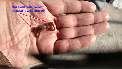

I removed this part from the siemens 3TF47 contactor. Now I forget where to put it back, I do not have another contactor to compare. What is the purpose of this part? the manual does not mention about this part. If anybody have experience with this, Please help me.

Congratulations you are on the way to become an engineer. Dont worry where to put the part. Just learn from it for the next time to take notes when take apart something unknown. Maybe take pictures of the disassembly process.
Last but not least You must not use this part as in do not use this part in a live circuit.
Buy a new one and keep this as a reference, in memory of a steep learning curve.

Great find. Seimens ofcourse put it there with purpose.
Leftovers during a disassembly and reassemble is a sign that something supposed to be there with purpose and now is lacking. Seem like seconds to disaster kind of thing.

Take another Siemens 3TF47 contactor apart carefully noting the position of all components.

You might check this web page for spare parts, and figure out how to put them back where they should have been left.

3TF47 contactors have been out of production for going on 20 years now, you will not get any help from Siemens, they will simply tell you to replace it. They were very inexpensive contactors, you can replace them with another inexpensive contactor. You have likely already wasted more time that they are worth and spending any more time is only making it worse, unless you put zero value on your time.

They do look like contact elements, though your pics are quite small.
On THIS Siemens contactor spare parts supplier page you may be able to recognize the identical matching part:

Hello All,
After some research I came to know that the part shown in the photograph is the interlock between contactor switching and the arch chamber (safety). When the arc chamber is removed the contactor will not operate. Trying to fix it now.

130: Anti-vibration ring

No, that shading coil would be embedded into the armature pole face. If broken out or missing the contactor would still function, but would vibrate severely.
