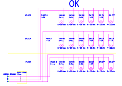

Hi, Say in a three phase system, in R phase we have a line current 0f 5 Amps, in Y phase of 6 amps, and in B phase a line current of 4 Amps. But it is visible that the load is not balanced in three phases. How to go for load balancing? Regards,

load moving is okay......but the loads are (2.A + 2.A=4A; 2.5A+2.5A=5 A; 3A+3A=6A), so, how can we move 1A to R phase to make it 5 A? because the loads are 2*3A in B phase ie it can only be moved in 3 Amps.
My further concern is using RCCB/RCBO here (or in similar cases of current imbalance in three phases), if there is a current difference of more than 30 mA (sensitivity), because there is more current difference already than sensitivity.

That description sound like you are using three single phase Ground Fault Interrupters on a three phase power application rather than a correctly designed three phase GFI device.
Use the correct devices for the job and the balancing issue won't be a problem being you will never ever get a three phase load to stay balanced to within +- 30 mA no matter how hard you try. Basic system voltage variation over time will guarantee it to be impossible.

RCBO takes all 4 wires, 3 phases + neutral through its 30 mA operating detector, it operates on the residual current. Normally, any current going out through one wire of four is balanced by current coming back in another wire(s) - look up "Kirchoff's Law" - there is only a residual if current goes back to source via ground or another circuit.
It does not matter if the 3 line currents are not balanced - any unbalance is cancelled by the neutral current coming back in the opposite direction.
https://en.wikipedia.org/wiki/Residual-current_device
There is some residual in a healthy AC circuit if there is unbalanced capacitance to ground but most circuits are OK - could be problem with circuit with equipment with lots of Electro-Magnetic Interference [EMI] filter capacitors to ground.

<...using RCCB/RCBO here (or in similar cases of current imbalance in three phases), if there is a current difference of more than 30 mA (sensitivity), because there is more current difference already than sensitivity...>
Nonsense. That is not what a <...RCCB/RCBO...> is for. The device is not there to deal with imbalance, as imbalance is normal; what it does is establish that the vector sum of all currents passing through it does not exceed its trip setting. So the neutral conductor must pass through the device as well. The vector sum is inferred as the current passing to the earth conductor, possibly via a human being. If that current exceeds its trip setting, in this case <...30mA...>, it operates to disconnect the fault.
Imbalance is normal, regular, and expected; it does not constitute a fault nor anything worth tripping over, and certainly not at <...30mA...>.

So swap a 3A load with a 2A load instead.

Simple. Take any 1A single-phase load off the Y phase, and connect it to the B instead.

When designed, the designer tries to allocate balancing 3 phase. But when used not always get the 3 phase balance.
Can replace four poles RCBO by four poles MCCB combination with 3 ELCB 2 poles.
If the neutral wire is out of RBCO, you'll get an error
