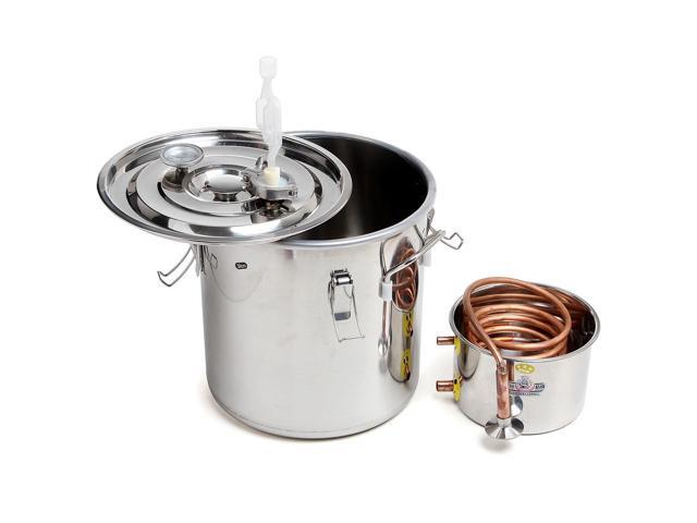

I wished to fabricate a compact desalination kit using induction based distillation unit at around 2 litre capacity. Can anyone suggest any quick method for either condensing or evaporating 1litre of water ?

Thank you for ur answer. But is there a quicker method for condensation? Here the hi-tech device that you mentioned takes nearly an hour for desalinating 890ml of water

Yes but it is hand operated...no juice required...If you're boiling the water, it will condense as fast as you can boil it off...but energy is required....You want more water faster get a bigger pot and bigger fire and a bigger still....What is the application for this device?

You can run the distillation tubing through cold water to facilitate rapid cooling and condensation in a more compact package...and use a relatively small amount of water in a larger 5 gallon vessel, just be careful not to burn the pot...However for induction heating a magnetic pot is necessary....
...or buy it ready to go....this is a SS pot....
