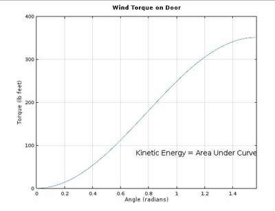

During last week's Noreaster here in New England the wind got behind my storm door and blew it open, bending the hinges out of shape and demolishing the door closer. I am just curious what the approximate forces acting on the hinges might have been given the following parameters:
Door size 36" X 80" Door weight 50 lbs
approx wind velocity 60 MPH
Assume that hinge travel stops when door was perpendicular to the wind direction and the door was swinging at the wind velocity when it came to the limit of the hinge travel

It's actually worse than that. 234 lb was just the wind force when it came to a stop.
As the door opens, the wind force increases as the area exposed to the wind increases (proportional to the sine of the angle), applying a torque to the opening door equal to force times half the projected width of the door (also proportional to the sine of the angle). The amount of angular kinetic energy imparted to the door is this torque integrated over the angle, 0 to 90 degrees. (Rotational kinetic energy equals torque times angle.)
When the hinges and door closer attempt to stop it, they have to apply a counter torque to the swinging door to stop it within a small angle. Again, rotational kinetic energy equals torque times angle. The smaller the angle, the greater the torque. This inertial torque is in addition to the torque from the wind force.
Since the door closer and hinges are so close to the axis of rotation, the forces on these are very large. If you estimate the stopping angle of the door, you can calculate the total torque required to stop the door and resist the wind force. If you divide this torque by the distance from the hinge to the door closer, you can calculate the forces on the hinge and door closer.

I suspect you guys may be missing something. When I was in school many moons ago, we studied something called, I think, "impulse and momentum." I totally forget the equations, unless I dig out my old physics book or Google it. But I'm pretty sure it had a Δt in the denominator. As Δt gets small, the force can become huge. Thus, the quicker the storm door stops, the bigger the forces on the hinges, closer, and whatever else. I looked at this for my high jumping (in a big school I wouldn't even be on the team), and the force on my heal was tremendous. No wonder I broke several of the "unbreakable" Fiberglas heel cups!
Lehman57
Re: Wind damage
03/19/2017 4:00 PM
You can look at momentum and time (momentum/time = force) or energy and distance (energy/distance = force). Most of the time, after the fact, you don't know about stopping time, but you can figure (or guess) stopping distance.
The swinging door gets kinetic energy from the wind:
E = ∫τ dΘ, where Θ is the angle of the door, and τ is the torque from the force of the wind on the door which is pivoting about its hinges.
The torque is: τ = F x r where F is the wind force and r is the distance it is applied relative to the hinges. If the door is width w and is open angle Θ, r will be
r = w/2 sin(Θ).
Force, F = P w h sin(Θ), where P is the wind pressure, w is the width of the door, h is the height of the door, and Θ is the angle the door is open.
So torque, τ = F x r = P w h2 sin2(Θ)/2 and kinetic energy is the integral of this from Θ = 0 to π/2
E = .5 P w h2 ∫sin2(Θ) dΘ = (π/4) P w h2/2
∫sin2(Θ) dΘ = (π/4)
E = (π/4) P w h2/2
Now to get the torque applied by the hinges and door closer to stop the swinging door, divide Kinetic energy by the stopping angle (in radians). The smaller the stopping angle, the greater the torque required to stop the swinging door.
Add this stopping torque to the torque from the wind force to get the total torque. To translate this torque to force on these components, divide total torque by their separation.
