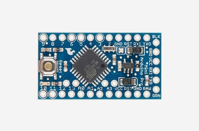

Re: build a cheap quadcopter
04/12/2017 2:26 PM
Arduino Nano. Weighs 6 grams versus the the Uno's 25 g.
Obverse side.
Reverse side.
Also consider the Pro Mini, made by Sparkfun Electronics. Weighs 2 grams - less than the weight of the Uno's headers.
It has 14 digital input/output pins (of which 6 can be used as PWM outputs), 6 analogue inputs, an on-board resonator, a reset button, and holes for mounting pin headers. There are two versions: one runs at 3.3V and 8 MHz, the other at 5V and 16 MHz.
These are lightweight enough where it becomes feasible to use multiple controllers, each given its own subsystem (such as a camera gimbal).
Whatever else you do, you will need to increase your battery voltage. 3.7 V doesn't give you enough headroom.

Thing about the Pro Mini is that it comes without built-in USB circuitry, so an off-board USB-to-TTL serial converter must be used to upload sketches (Arduino's name for 'programs'). For the 3.3V Arduino Pro boards, this can be a FTDI TTL-232R-3V3 USB - TTL Level Serial Converter Cable or the SparkFun FTDI Basic Breakout Board (3.3V). For the 5V Arduino Pro boards, use a TTL-232R USB - TTL Level Serial Converter or the SparkFun FTDI Basic Breakout Board (5V). The Pro Mini is intended for permanent installation once you've uploaded the program and no longer need USB capability. This won't stop you from using a TTL-to-USB converter, which you can remove after programming. If you need the USB present full-time, use a Nano instead for an additional 4 grams of weight.

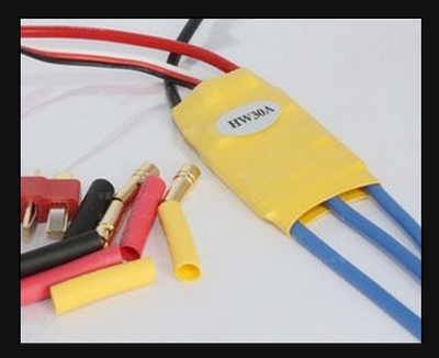

There is a device called an ESC, or Electronic Speed Controller, which is made to interface a PWM signal to a motor. You need one for each motor and the motors have to be 3 phase AC.
https://oscarliang.com/build-a-quadcopter-beginners-tutorial-1/
