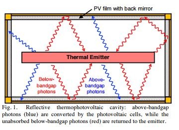

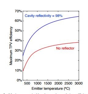

One technique to boost efficiency is to enclose the thermal emitter in an optical cavity so that the unabsorbed photons can be "reused".
http://www.johnholzrichter.com/lib/literature/TPV-Lecture-6-2016.pdf

Most of the photons that are not converted to electricity are reflected back into the cavity and ultimately reabsorbed, increasing the temperature by a minute amount. Some are absorbed by the mirror and the energy eventually radiated to the outside. But most of the unconverted photons are reflected back causing the temperature to rise. The hotter the interior of the cavity, the higher the average photon energy and the better the chances that new, higher-energy, shorter-wavelength photons will become available to be converted to electricity. At some point the system will come to thermal equilibrium when the energy emitted by the source equals the energy lost by all the processes involved, and the cavity temperature will stabilise.

That is a good idea. I saw something akin to that in discussion of molten silicon energy storage. Basically they used dichroic mirrors to selectively pass band of interest to the TPV cells, these tuned to a narrow band, so that unusable portions of spectrum were routed back to the molten silicon (thus de-coupling energy losses). I am sure a lot more remains to be worked out for a high range efficiency device to be available.
