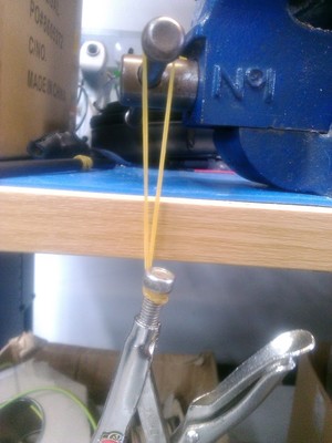

For what it's worth, I was just in the lab and noticed I had everything I needed to try it out: rubber band; weight (pair of mole grips); a place to hang it (vice), and, a heat shrink gun.
Before
After
It actually went up about twice as far, but, had obviously started to cool by the time I could take the picture.
Re: Rubber and Heat
05/04/2017 2:50 PM
Do it again, and mike the thickness and width both bold and hot and report back here by Monday!
