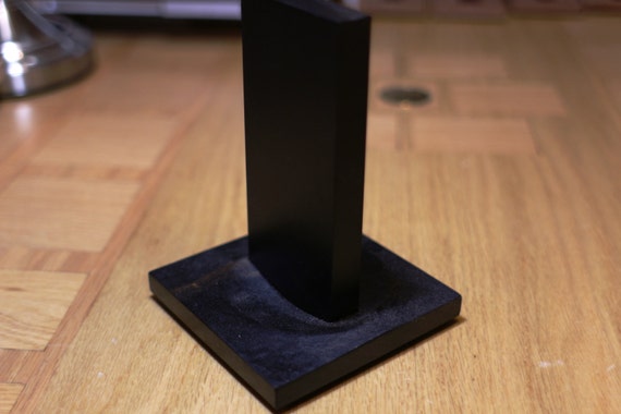

That thingo in S.E.'s pic is not a block of wood, it's 304 stainless steel with a coat of Cerakote Gen II Black (http://madcustomcoating.com/). About 10.4 pounds sans wooden base.
Btw 11 tonnes is not 11 tons. One tonne = 1000 kg = 1.102 (short, ie, 2000-lb) tons.

06/04/2017 1:05 AM
"The installation is 6.0m high x 1.4m wide."
What of its third dimension?
How is it shaped? A cylinder? A rectangular prism? A steel slab 163-169 cm thick? Is it asymmetric, that is, does its effective cross-section vary depending on wind direction?

If it's steel it's about 6" thick...
Re: Working Out the Tension on a Screw Pile
06/04/2017 3:17 AM
"163-169 cm" should read "163-169 mm". About 6.4 to 6.7 inches, depending on the steel used.
