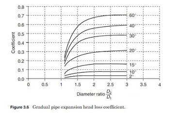

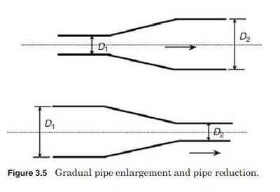

I need simple CFD simulation of transition of water flow from a converging cone to a straight pipe. What is good maximum cone angle, where no boundary layer separation will take place?

I'm thinking the shallower the angle the better. Here is a plot of pressure drop factor as a function of angle:
Source: http://www.academia.edu/24098120/Piping_Calculations_Manual
As the water enters the reducer, the velocity increases, inversely proportional to the crossectional area (constant volume flow). The onset of turbulence is determined by the Reynold's number of the flow.

A: Anything where the Reynolds Number is less than 2300 or so.
Re: CFD Analysis of The Boundary Layer Separation in Water Flow
06/13/2017 11:28 AM
Basically, PWSlack is correct. Any flow condition that remains essentially laminar will not separate the boundary layer, but turbulent flow will disrupt the boundary layer to whatever extent is possible at a given Reynolds number.
06/13/2017 11:59 AM
Simplistically, bottom-line, other variables being equal, the longer the cone, the smaller the angle, the less (disruptive) is the transistion...
