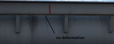

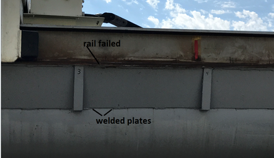

The original design and the repaired design for the trash rake did not meet the load requirements, so I need to create a preliminary design of a new system or modify the existing one. I need to complete a thorough load calculation and design the system accordingly.
I have attached drawings that might be helpful.
The original design failed, so general maintenance welded some plates underneath the rail to support the system. Maybe it will work for a long time, that is one of the things I need to figure it out. I don't have the WPS for the welding done, so we would have to guess about the welding.
Any help would be much appreciated.
thanks,

what broke was the rail, the lower part started to deform as you can see in the picture bellow (hopefully is large enough). So the trash rake only inclines (angles out) on the east side, so after a while, the rail buckled. You will see in the detailed pictures.
It is a hydro plant.
they installed tese plates for support. compare the condition of the rail in this picture with the next one.

It looks like corrosion+plus weight damage. Was there a lot of rust in the weak/damaged area's.

If there's rust driven damage to the rail it will strain the system and cause further problems. Keep the rail in top shape and all will be well... With PM
I completely understand how the rail could be damaged over time.
Replace or repair. Done well either will be fine.
I like the support plates. Just try to avoid creating places where water doesn't drain and dry quickly.

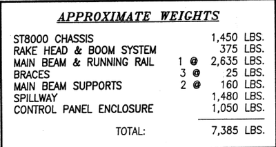

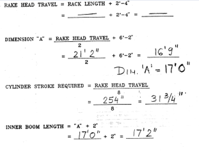

I did some research and did find some good original drawings by the manufactor back in 98. See drawings bellow. I have also found some basic information about the rakes.
It is an Atlas polar model st8000. The lift capacity is 1250lbs and the whole thing weights in at 7385, as you can see in one of the drawings. The speed of the water is 2.85 feet per second. Theoretically it could go as deep as 34 ft bellow deck elevation.
Believe it or not, but the machine that needed repairing this past year was sent to be refurbished only 2 years ago. They did quite a few things:
  1. Modifying the brushes on the trashrake head as well as the springs and replacing all of the fasteners with heavier diameters.
  2. Redesign and fabrication of all of the trashrake boom guide rollers.
  3. Replacement of the main boom outer 14” square tubes on both rakes.
  4. Tweaking on the hydraulics in an attempt to smooth out operations to minimize the violent hammering that goes on when operating the rakes.
  5. Installation of auto-lubrication systems.
so, all that said, with the new drawings if you could provide me with you final thoughts about what I could do to repair and test the machine prior to next year?
any final calculations would also be greatly appreciated.
21" 6 1/2'' is the distance to the top of the rake

It looks like all of the mechanical force that contributes to bending the raking unit support rails is developed by one or two hydraulic cylinders. As the rake is pulled up, that force tends to pull the raking unit towards the downstream trolley rail, creating uplift on the upstream flange, and downward force on the downstream flange.
The maximum force bending the rake unit trolley beams is the hydraulic pressure against the rake cylinder bore(s), pounds per square inch pressure against the area of the cylinder, less the cross-sectional area of the rod, in square inches (plus dead weight). The river hydraulic forces do not add to this force. So your worst case is a stalled rake. Your pump pressure relief can be adjusted to bring the force in line with the capacity of the structure, or you need to increase the strength of the structure to match the pump.
It is unclear from the drawings how to calculate the moment on the rails, as the attachment point of the rake cylinder end is not shown. We need to know the distance (radius) between the cylinder end and the racking trolley structure, to calculate the force, and the distance between the attachment point and the trolley wheel contact points.
The other thing to consider, what is your escalation response in the event of a stalled rake? It appears that the correct response needs to occur sooner, to ensure you are working within the limits of your equipment.
The hammering of the hydraulics is very concerning, for such a simple mechanism. I doubt whether you have determined the real root cause of that. Mechanical components are likely bending significantly while in operation; no amount of hydraulic circuit modification is going to fix that, just mask the real problem.
