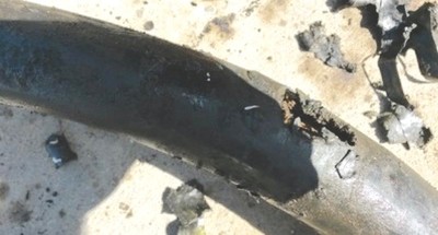

Dear Electrical Engineers
Can anyone tell what is the reason for this cable damage?We suspect rodent bite.
Same damage has been found 3 times in a week in cable trench.

You have not told us the voltage class, type of insulation, type of installation, and/or the type of covering fill. Without knowing any of these, the damage looks consistent with low voltage thermoplastic insulation directly buried in rock fill, possibly with traffic or equipment movement directly above the trench.

On my computer, the cable part of the image is very dark. After adjusting a few parameters, I can see a bit more:
I don't see any evidence of tooth marks, so until I see a more detailed image, I'd rule out animal damage.
It looks to me like cracking due to age, exposure to UV or chemical, or to mechanical stress.
When you say "in cable trench", do you mean that it was direct burial, and you found this after digging it up? If so, It could be damage from the digging tools/machines...

Cable is laid in cemented cable trench,not filled.Cable is 185sqmm 3.5 core , 600V ,CU/PVC/PVC.
No digging tool or chemical.
But found water in cable trench.

seems to have been burned by a short circuit spark

That is certainly believable! Covering the concrete trench with concrete cover/lid that is removable would require a reusable gasket also, and I expect the cost, inconvenience would put it out of question.
Obviously, any flaw in an open trench where rain water could accumulate with cooling tower drift salts, or ocean spray salts, where there is a conductive path to ground is a really bad idea.
Re: Cable Damage Reason
07/14/2017 11:29 AM
Not necessarily an actual short-circuit type spark. Any concentrated electric fields could conceivably be vaporizing water, accelerating the damage to the plastic.

In my opinion, it is a low voltage flexible cable ,sheathed with a kind of black rubber. A layer -of fire protection material, may be-it was smeared on the cable surface and it cracked when it was dry and bent after then.
Posts: 1395
07/14/2017 11:02 AM
PVC doesn't show well in some water immersion tests, especially 60C rated versions. If that is your primary insulation, might be a clue. The data on water immersion testing is somewhat dated, one in 1959,

This is the cable image. Approx.overall dia 61.5 mm. The bend radius seems to be about 8 times the diameter [it is as recommended]. No sign of mechanical abuse and no PVC jacket damage sign. Only the outside sprayed material is exfoliated.

You apparently wrote this response as a reply to post #20, and quote text therefrom, but your discussion of the picture must refer to the original post.
The picture in post #20 is quite acceptable, and in fact I'm betting that it was taken from either the cable fabricator's or the cable distributor's website. The cable end has been very carefully prepared to show all the layers, but with stripping way too short for any actual use I'm familiar with.
I indicated in post #8 that the original image was poor, and even went to the trouble to modify it to bring out the shadows as best I could. I had hoped that the OP would provide one or more better images, but so far, he hasn't taken the hint!

Can we get a couple more pictures? It is hard to tell if some of the dark areas are damage or shadow.
A close up of the edge of the entry/penetration would be informative.
