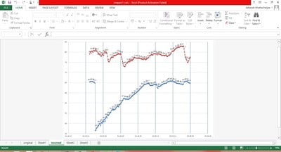

i have a climatic chamber which has no cooling system, temp is generated by air heaters and RH by boiler. They r controlled independently. The control system is PLC based auto PID. Conditions 65 deg cel and 80%RH.
yesterday there was a sudden drop in temp from 65 deg to 41 deg (data logging happens every 10 Sec) but no change in RH except normal variation between +/- 5%. after 10-15 mins temp came back to 65 deg. During the whole time RH didn't show any drastic change.
questions:
1. Why there was a sudden drop in temp?I m cancelling power surge here as I get stabilised and uninterrupted power.
2. Why did the RH not show any drastic change in spite of 20 deg change in temp?
explanations are eagerly awaited.:)

With that big of temperature change and no measurable humidity change, I would suspect measurement error. Maybe the temperature logger had a glitch. With temperature changing and a constant amount of moisture in the air the humidity would certainly have changed. Or maybe the temperature changed faster than the humidity sensor could respond.

Maybe a bad temp sensor or bad connection? A 24 deg C drop in 10 seconds seems a bit extreme. Did the temp come up suddenly or creep back?
The RH and temperature control loops are not truly separate. If you change the temperature, you change the RH. (That's where clouds come from.) The fact that RH did not change, to me, points to a temperature sensor error.

You are asking the same questions as me.
some pointers though
1) no one opened the chamber
2) The sensor was working fine when checked last, its a normal PT-100 and has been calibrated.
3) there is a very remote chance that a water droplet/condensation may have fallen on the sensor.
Question:
Is point three a valid argument?
I am attaching the zoomed pic. Please note that the complete protocol takes 10 days and this was the only glitch on 5th day, before things became smooth again.

If the water shorted out the leads on the sensor either at one end of the other of cabling, then yes, it would lead to large negative systematic error, problem solved.

When a temp sensor is wet, it is a 'wet bulb', not a dry bulb; half of a wet bulb/dry bulb RH sensor.
A dry bulb that becomes wetted continues to report temperature, but it is wet bulb temperature, not dry bulb temperature.

If you are reporting temperatures in centigrade, the dew point is 60 deg C for 65 degree air at 80% humidity. So a drip on the temps sensor should have gone to 60 deg C. The gradual recovery indicates that it was not likely a loose connection or electrical glitch.
Under the conditions described, you should have seen a great deal of condensation forming in the chamber and you should have seen the RH spike to 100%, since the boiler adds moisture to the air, but does not subtract it.
This depends on how the RH sensor actually measures the air moisture content.
I think there is more to the story.

Thanks for the reply. I was considering the drop as wet bulb temperature and not dew point. The RH sensor is rotronic capacitive type. RH is generated only by steam and a PLC controlled solenoid valve.
My question is, shouldn't the RH have shown a sharp drop once the temp started increasing?
I checked my PT-100 after the test, it was perfectly fine and giving correct resistance values.
The abnormality has created a lot of trouble in subsequent activities. Hence the persistence.
Re: Temp RH Discrepancy
08/02/2017 1:16 PM
The system RH response should be thus: decrease--> time constant for valve to open --> transfer function of steam into chamber --> response time of capacitive RH sensor instrument --> time constant for valve to close. If that cycle time is faster than the system changes in RH, then all is good, and you have a "tight" control loop. If not, then RH can "be all over the place".
Temperature sensor drop out with RH steady probably means that your system did not change all that much, but that the indicated values were misleading.
