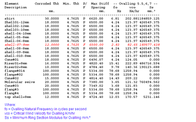

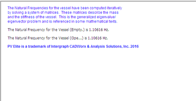

Re: Stack design_STS-1
08/22/2017 9:07 AM
After increasing thickness of components when I checked output for STS in pvelite, it is observed that still critical velocity for vortex shedding is less than the mean critical velocity.
To investigate further for the cause of failure, I checked ovalling frequency.
But I found that ovalling frequency is more than natural frequency of vessel even with less thickness of shell components. See below image for reference.
Still, I am not able to conclude the reason for failure.
I request you to explain the same if possible.
Thanks.
