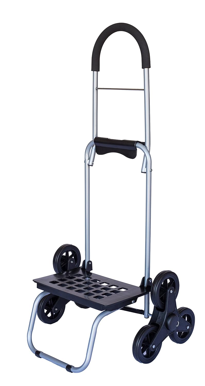

Now you just need to incorporate these stair stepper wheels into the design...for climb stair mode...
Re: Designing braking/accelerating system
08/22/2017 1:33 PM
Aren't both things you mentioned still under patents? I would suspect they could be.
08/22/2017 1:45 PM
There's room for more original ideas here....as always a patent search would be required for any thoughts on commercialization...
