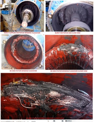

Dear All,

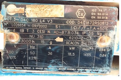

One of our plant motor has recently Burnt. It was newly installed and within 8-months even not being in continuous operation (Operating in duty cycle on/off).
Motor rating: 400Vac 50Hz 36A 18.5KW 1465rpm Cos phi 0.84
The operating conditions for this motor were same as of original existing motors that is balanced three phase power supply without any harmonics, no overloading (electrical or mechanical), ambient temperature less than mentioned on motor data sheet and name plate(+50°C).
Our Maintenance department has the following assessment:
1. Motor quality was not as the existing original motors.
2. The original motor Insulation class is F/F. While the burnt motor Insulation class is F/B. That is Insulation class F but limited to temperature rise of class B. (Motor data sheet).
3. The Type of newly supplied motor is D5C while the existing motor has type D4C. Same difference exists in their serial nos. (Manf. Confirmed motor is same but with new series).
4. The motor was supplied without any QA/QC, test certificates, performance curves, and conformities.
5. No factory acceptance test or third party inspection was made/involved.
6. Considering new motor from factory no tests were conducted by our maintenance department and motor was directly installed.
7. The RTDs in the motor were not connected to any PTC relay. As in original motor starter this option is not available. (Motor Starter Wiring Diagram).
8. The newly supplied motor had insulation failure specially the place of embedded RTDs. Two phase winding were shorted.
9. Protection system worked, the only short circuit by the MCCB found tripped and earth fault relay found tripped.
Could you please identify the true cause of stator winding flashover, and recommendation shall be highly appreciated.
Please feel free to ask any further details you may require.

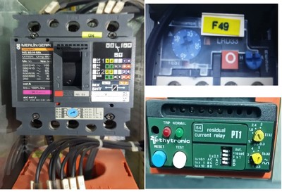

Yes it could be the reason. But we have its starter with protection. the circuit breaker NS80H - MA, Thermal overload relay LRD33 are perfectly coordinated. Residual current relay. we found them tripped but stator winding phase to phase were already burnt. Seems protection worked even winding damage occurred. This motor is DOL start. Its RTDs we did not connect to any protection. As in original design there is no thermistor relay. As the motor was not thermally protected, might be damaged for this reason. I am not sure.

To me it sounds like your protection circuitry worked exactly as designed. When this inferior motor failed you did not get an uncontrolled fire in your plant.
Usually one shouldn't blame their seat belts for the accident that ruined the family car. One should praise the seat belts for saving the family.

In my opinion, since the damaged part it is in open position- not in a slot -it is not likely to be an overloading the cause. However, if it was not high-potential tested I don't think the overvoltage was the problem- as the rated voltage seems to be low.
I think the winding was damaged mechanically while in assemble process and withstand it-damaged-for a while.

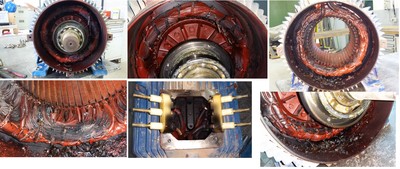

Some more details:
It is fan cooler motor belt driven. It is being used to cool inlet gas from compressor.
A pitch controller is the only load varying factor. The operator monitors the inlet gas temp. and accordingly set a command…. motor to run and adjust the fan blades to some angle via a pitch controller to get maximum cooling. If he set fan blades angle 100% then motor runs at its rated amp 36A or bit more 37. The burnt motor was operating on 36/37 Amp as the fan blades runs at max. efficiency 100% max blade pitch angle.
For similar motors whose fan blade pitch angle is set at 75% runs at max. 22 AMP.
Hence swap of these motors depends on gas temp. In summer they run all and in winter some off. Their operation start/stop is manual by control room operators.
The original motor had a rotor run out that is slight rotor bend. Due to a high tension belt and long idle condition. It was rubbing against Bearing inner cap. Thereby violating the clearance. As these motor are used in hazardous area Zone -0, So we replaced it by new motor. The old motor worked for 15-years with normal PM and routine overhauling.
These motors are Ex Proof, and are designed for harsh environment like ours (Gas Plant) in desert. Some of these days temp reached 48°C. In extreme winter its goes to -5°C. Humidity max reaches to 89.
Similar other motors are working under same condition for the last 15-years.
All the rest winding are clear, no sign of overheating there. Only the spot shown is affected. It was like huge spark which melted the broken conductors, blackened the drive end cover, rotor side etc. Short like welding arc.

7anoter4, I agree with you to suspect mechanical damage during manufacturing. If that motor was meg- gered before installation it might have failed.

In my opinion this is an insulation protection due to motor's vibration (weak insulation design).
In my opinion given this little tidbit of information, someone damaged or compromised the winding installation in the process of embedding the RTD, then the lack of QA/QC, testing, documentation and acceptance testing at your end allowed this defective motor to be placed into service.

NKA, you actually thought you had an EX proof certified motor. It may be that it failed that rating already in the manufacturers factory. You could have had more than a blown motor. Purchasers are people that must chase and source the exact equipment as classified/certified by the Engineer and it must not be up to the maintanance staff to ensure the correctness. The data sheet for this motor already failed the test even before the order was placed. The purchase department at your facility think they are the qualified people and will still cost you because they report to the financial officer. (Just my gutt feeling) you can correct me.

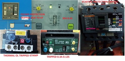

Thanks to all of you for your valuable analysis. I understood now the protection system for LV motor without being connected with RTDs does not see the wear and tear in the motors, insulation degradation, heating due to bearing problems, inercaps rubbing, greecing etc. Motor draws still rated amperes or even bit low, till insulation failure and overheating of winding lead it to short circuited and earthed.
Both of these two motors 18.5kw and 37kw were connected in star. Direct on line starting not VFD. they were from renounced manufacturer Marrelli Motori Italia.
18.5 KW motor was new but 37KW motor served for ten years almost in continuous operation.
The 18.5KW motor was belt driven, had insulation failure due to manufacturer defect.
37KW motor had mechanical overheating. It tripped two weeks b4 on overloading. Maint. Dept found everything Ok as they could not guess that problems are mechanical. They reset the overload and put back motor in service. two weeks later it burnt. Electrical protection could not detect and once winding overheated, two phase short circuited and earthed. it tripped all its protection along with main feeder, thereby tripping the whole MCC. I found the contractor was stuck (pressed inside), one contact was quite sparked and the bottom iron core was broken.
In conclusion LV Motor protection simply with thermal OL, residual Current Relay and MCCB (For Motors) can not detect moderate mechanical overloading/overheating, heat and losses due to wear and tear, bearing and inner caop rubbings etc.
In this case RTDs have to be connected with some PTC relay to trip the MCCB. or probably the new electronic thermal OL relays with TESYS starter might be effective.
