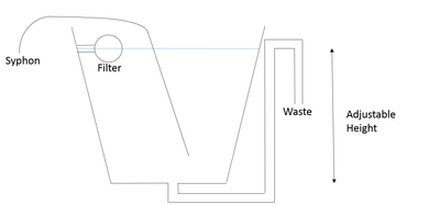

Thank you, the siphon idea is a very good and simple plan . Gravity can be wonderful . Would it be possible to send simple drawing I could follow before I drill holes and install fittings thru the expensive tank

This is a very quick sketch of the tank setup we used. It provides three methods for cleaning the tank. Firstly, out the bottom of the tank we took the waste pipe back up the side of the tank in an upside down U at the top. The height of this is adjustable and controls the level the water is at. There was actually also a valve in this line about half way up which dumped to waste too, so you could crack this valve open and dump half the contents. You could also drain it completely if you opened the valve at the bottom (again I haven't shown this).
Next we have the filter on the side of the tank near the top. We would adjust the adjustable section to raise the water level to the filter and this would continuously overflow through the filter and out of the tank, which would take scum off the top.
Lastly we would use a hose pipe with PVC tube on the end as a syphon to clean parts of the tank the other methods couldn't get to.
This was for juvenile cod and the tank would be either 10 m^3 or 20 m^3. I don't know what your application looks like so can't provide any specific advice but I'm just showing you how we used gravity to provide 3 cleaning methods, no batteries or electricity. Perhaps you could use some or all of these for your application.

Thanks MACA , I think this design will work on this project . I will be making the tank from scratch using stainless steel and I wanted to minimize any changes once I got started . I appreciate your taking time to send drawing

as you are making the tank yourself, be sure to do a cone bottom. this will help direct the sludge to the drain and help facilitate the cleaning process

You could fit the syphon loop to the existing drain valve, leaving the valve open.
I'm assuming the existing drain is at the lowest point in the tank, where the sludge collects, and is effective in removing the sludge. The height of the loop can then be adjusted externally and modification of the tank is not required.
