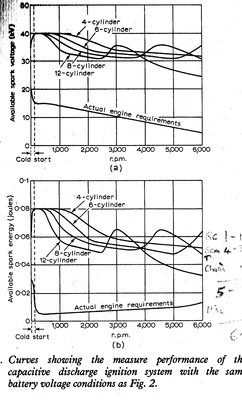

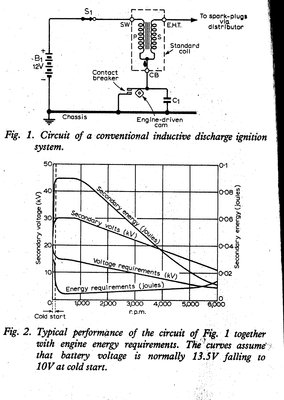

A little bit of info that might help. From Jan 1970 "Wireless World" electronic ignition article. Welcome to UK! The "energy requirements" are stored energy in coil or capacitor - rather than what reaches the spark gap. For gas turbine ignition, only 1/4 of capacitor stored energy reaches plug - about 1/4 remains in capacitor, rest disappears in resistance.

Re: Electrical specifications for BOSCH ignition coil No. 0221119027
09/22/2017 12:38 PM
Thanks for information.
I think this magazine "Wireless World" was Reed Publication and there was some extra name to it. I published few articles in it 25 years ago. I also won editor's prize. I think they were paying 100 pounds for normal idea and double for selected editor's best.
