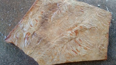

I'm building a flagstone walkway.This piece will be at the "house" end of the walkway. When I got these about 15 years ago I didn't notice this crack in the side. The stone is 30" high at the peak and 40" wide and the crack is across the entire top surface. It is loose, but not cracked or broken. my best guess is that the crack runs through about the top 30% of the stone and I'd hate for it to break after it is installed.
My thought is to simply thin some epoxy with MEK and slowly fill the crack as best as I can. I've got kool deck repair plaster but it is too think to use here.
Any suggestions are welcome.

That's a tough piece to deal with. No matter how nice and sound the repair or substrate you'll always be giving it those Gary Coleman eyes.
I've had great luck with lesser flagstone in worse situations and less attention.
Sound ground is the most important prep.
You have a fine plan. Some edge bonding will mitigate potential flexibility.
Pressing high strength repair grout into the crevice will do the same.

Can you just flip the stone upside down, and put the side with the thin crack down? If so, you could force the cracked section to break off, and then once it's installed you'll have nothing to worry about.
(Here's where the OP adds more info to the problem...)
Re: Stone Repair
09/24/2017 6:20 PM
It's a long story about how I came to possess these stones, one at a time. (legally)
It's another story about how it took 15 years to have the time to attack a project (has to do with adoptions) that I expect to take much more than a day.
These stone posses unique visual features on one side only, indicative of when the sediment was deposited millions of years ago.
Turning them over is not an option for me.

Not personally familiar with repair of stone, but have heard of methods that use vacuum to encourage adhesives/fillers to get into small crevices. A bit like windscreen repair that by removing all gas, then the filler/adhesive must occupy all available voids.
Primary suggestion is that thermal expansion rate must very closely match that of the original stone, or else failure will happen in freeze/thaw cycles.

What about hydraulic cement? You should be able to get enough in there to at least prevent water from getting in. It's also paintable about an hour after using it so you could match the color of the stone.

Because of the brittle nature of the sandstone, I'm hesitant to break it, but if it cracks for some other reason, that could work.
Hydraulic cement will seal the edges but leave a space between the fragile top layer and the parent rock which I feel sure would break when a load was applied. I may have the same problem with the thinned epoxy but I think I have a better chance of completely filling the crack if I take my time.

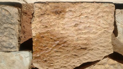

How about completely setting the piece in cement with a 1" to 2" edge around it. You can precolor the cement as you are mixing it or paint it after to match the stone.
I have seen stamped concrete that you have to look twice at to realize it's not stone.

My plan is to tamp the soil level, soak it, then check for level and lay a sand base, then concrete all the joints. I've also considered setting it in mortar and finishing the edges with colored mortar. I figure to do small sections at a time and that would be better than a sand base.
It won't see any heavy traffic so I may do a small test first. We have pavers all throughout downtown and they are all laid on a sand base with a concrete border.
They are also done by experts and I'm just a hack.
I still have to lay out and fit the stones before the first one goes down. I'll do that on the other side of the driveway then lay them one at a time in small groups.
I haven't thought about sealing it, my inclination is not to.
I've had a 3x6' section laid for 10 years and it is none the worse for wear, except where it has settled due to poor workmanship on the installer's part.

The down town pavers are probably laid on sand (or a dry sand/cement mix) that has been compacted with a vibratory tamper. They will also all be the same thickness so laying an even top surface that the public can walk over without "tripping and suing" is relatively easy. Your stone will all be of differing thicknesses and maybe not parallel top to bottom so a simple sand bed beneath the stone is not practical. You cannot tamp the whole area level as the finished surface would have trip points and tamping under individual flags will not be consistent, the flags will settle, move and most likely crack over time. Lay on a 1"-1½" thick bed of soft mortar 6 parts sand to 1 part cement that is troweled into ridges so that as the stone is placed and pushed down the mortar from the top of the ridges is displaced into the troughs and has somewhere to go. Tap the stone down into the mortar with a rubber mallet until the top is at the correct level relative to the adjacent flags. Once the mortar is set this method provides support over the whole base of the flag so it will not rock or crack. I don't know how old you are but I suspect that you don't want to relay this path twenty years from now. A word of caution. Sandstone will erode quite quickly with continued foot traffic. If possible place the patterned features that you want to keep in positions away from immediate footfall.

This will depend on the geometry of the crack:
Tape the edges with a strong tape, leaving a gap for inserting the adhesive on one side and a gap for a shop vac on the other side.
The vacuum from the shop vac will help suck the adhesive deep into the crack. You'll likely need one person to hold the shop vac nozzle while you apply the glue to the crack on the other side.
Maybe tape some cheesecloth over the shop vac nozzle as an indicator the glue is coming through.

I've made my first application of about 2 cc of thinned epoxy. It may all be absorbed into to stone. I won't know until it has cured or the solvent has flashed off and I make another application.
Eventually some will run out of the side and I'll have an idea.
I may reduce the solvent content and move the rock into the sun to warm it and thin the epoxy that way.

I know nothing about thinning epoxy, but my gut feeling is that the end result will be weaker than unthinned epoxy.
I do know there exists a very low viscosity epoxy. I have a friend who uses it to repair the wooden spokes and rims of old wheels. I understand that it soaks all the way through the wood, leaving an authentic original wooden spoke as strong as the original. I don't know if it is a one- or two-part epoxy. If you are interested, I can ask for details.
Re: Stone Repair
09/25/2017 11:35 PM
I expect your friend may be using a commercial version of my home blend. By adding a volatile thinner, MEK or acetone, with the mixed epoxy, the thinner all evaporates leaving virtually 100% of the base epoxy resin behind. Typical coatings such as this are 10-30% solids and the rest evaporates away and allows curing to take place.
Same with paints. Rattle can spray paint is mostly solvent.
I'd be curious to hear about it none the less.

I finally remembered to stop by my friend's place. The stuff he was using is:
I should have taken a picture of one of the cans (it is a two-part product), because it had more chemical information.
INTRODUCTION TO KWIK POLY®
KWIK POLY® is an entirely new product and material to most people. Kwik Poly® is a trade name, and the product is a Polyol using two agents, a base and a catalyst. Because of its wide versatility, it will repair and preserve things that were previously considered unrepairable and routinely thrown away. It is combination filler, coating, and bonding agent. Restorers, hobbyists and people in all industries have longed for some material that is easy to use, sets up in minutes, and can be mixed and applied in any consistency depending on the job requirements. It will also vary in strength and physical properties depending upon different materials (fillers) that can be added into the two base liquids. This fast curing material is also impervious to gasoline, oils, thinners and most acids, yet will accept any type paint finish beautifully. It can be readily sanded, driller, sawed, nailed, cut and worked very much like hard wood. It can also be machined, tapped, turned, shaped, ground, and polished like aluminum.
Kwik Poly® is initially a very thin fluid combination much like water, and its penetration quality in porous material is unmatched. Another of its key advantages is its ability to combine with tremendous amounts of filler, which can then be utilized in filling voids, dents, pits, and gaps in almost any situation, on just about any material.
Kwik Poly® cures (dries) by the heat of chemical reaction between the two base materials, light and dark, which in that respect is similar to epoxies including fiberglass. However, this chemical reaction takes place much faster, which is another of its outstanding qualities.
Fillers can be just about anything imaginable and may be added in any quantities suitable for a particular job. Each Kwik Poly® kit contains an excellent silicon filler, but one can add or substitute any type of dry material such as sawdust, spackling powder, plaster of Paris, concrete, sand, flour, gravel, and just hundreds of other dry goods.
When mixing products such as milled fiberglass, metal shavings, glass beads, and concrete, a much stronger, harder and more durable material is achieved. The end result will directly reflect what type and amount of filler used if any.

Thanks for the information. Polyol is a rather generic term, but I'm going to order some anyway for another small project..
I'll look for an MSDS to get more information.

I would cut the stone in half, then split the cracked piece, and then stick it back together....with mortar or grout...

Not feasible for me. That would require a 40" long cut. The stone is 1 1/2" thick.

So far I'm liking the tamping. Wet settling and plopped onto a heap of mortar method.
I've set quite a few stones this way. It's the way to go in a tricky situation. It's Important to put down enough mortar that pushing down will settle it to the desired level as lifting up is an exercise in futility.
The bonus is that you can leave controlled gaps that can be filled with mosses, gravel, dirt, water etc.

Me too. I can use a redwood frame and the driveway on one side for the slope and a 2x4 for leveling each stone. I have 1x2' redwood framed pavers between the pool gate and the kool deck.
I'm leaning toward mortar to fill the gaps, no further maintenance and easier to hose off.
PES, I did that long ago on a smaller walkway and didn't like it. You can't mow the grass and weed eating stains the stones sometimes. And here in the desert the grass may die. Thanks for the idea.
