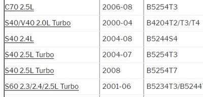

Randall, have you seen this page. Can you tell us, which engine identification number you have.
And which code you received on your scanner.

Strangely they (TroubleCodes.net) don't seem to acknowledge the existence of my model 2007 S40 Diesel Turbo 2.0L
