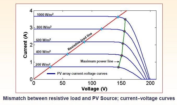

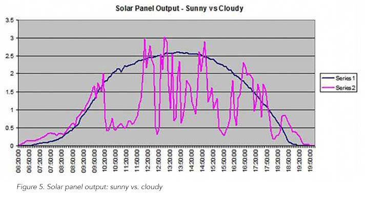

100 watts at 120 volts is a resistor of value 14400/100 or 144 ohms. To find the amount of power delivered to a resistive load, you need to consider the load and source using load lines and the voltage and current characteristics of the source.
A photovoltaic device produces almost constant voltage but the current produced is proportional to illumination. To see the relationship, see this calculator.
http://www.pveducation.org/pvcdrom/effect-of-light-intensity
An example load line vs photovoltaic output is shown below:
https://www.mouser.in/applications/sophisticated-management-solar-energy/
So with your resistive load, the output voltage will vary directly proportional to illumination.
Solar illumination varies through the day, mainly because of absorption in the atmosphere (see Beer's law).
https://en.wikipedia.org/wiki/Beer%E2%80%93Lambert_law
https://www.cat.com/en_GB/articles/white-paper-hybrid-microgrids-the-time-is-now.html
Assuming your "appliance" can accept up to 120 volts, the voltage you can expect during any other time of the day if you connect it directly to the solar panel would follow the plot above, scaled for a maximum of 120 volts.
So if you want it to work all day and not just at noon, you need some kind of voltage regulator and a large enough array to produce enough power in as early in the morning and as late in the afternoon as you wish it to operate and limit the power at midday. The sun furnishes about 1000 W per square meter (at midday), but with the efficiency of solar cells you can expect about 150 W per square meter.
The daily variation is one reason to use batteries. A smaller solar panel could be used to provide average power for the day, and the solar panel output could still be used to switch on your appliance when the sun is out.
