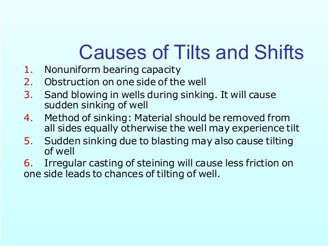

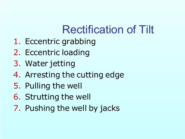

I suspect the walls are not properly supported...digging the bottom lower without furnishing proper foundation support for the casing steining...
Tilt and shift in well foundation
https://www.slideshare.net/YogeshKherde/well-foundation-32567628
