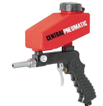

The biggest problem I see is the lack of adequate compressor volume/power.
I have one of these pancake compressors that I use for airing bicycle tires and even that strains it. Inflating one tire will cause it to start and run for awhile.
I've also got a blow gun almost exactly like the one used here and the gun will drain that compressor tank in about 30 seconds.
So, nothing wrong with the concept, but you'd better have at least a 5 hp compressor to run it. I say this because I also have a 2.5 HP single cylinder, 21 gallon compressor that would not support this either.
And finally, that "old bolt" he blasts is a threaded coupling, not a bolt at all.

agree,... from Harbor Freight the Average air consumption 7 CFM @ 90 PSI.
And that's normal on the shy side. The more air supply the better becassue basically, you have live air exiting.

$19.99 at Harbor freight and it works well for very small jobs. I have one for misc. blasting.

How big is your compressor?
I might buy one of those guns, if you give me the right answer. I've got some angle steel I'd like to sand blast. I can get sand free.

My tube fed blaster was under $15 new and may be aa many years old. It will work with the smallest compressor... For about 3 seconds.
Using a "large" compressor it's like a water pic compared to commercial units.
Bike frame? Okay..
car? Take time off.
... BTW.. free sand? Leave it on the ground

As a rough guide 4.5 c f m (Displacement) per HP.
3.5 c f m (Free Air) per HP.

The specs on my compressor are as follows:
5.5 HP
20 gallon tank
8.3 SCFM @ 40 PSI
5.8 SCFM @ 90 PSI
Max 125 PSI
When I'm spraying lacquer or using the sandblaster, the compressor almost never stops running to keep up. At times I have to stop to let it catch up. I had purchased it more for my nail guns which I can run all day with this compressor.
