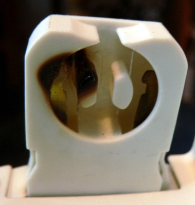

Just before setting up my T8 lights for winter lettuce this year I became aware of a recall:
Reason for the recall is given as follows:
"The lamp sockets in the metal light fixture can lose their connections and pose an electrical arc and fire risk."
My own shop lights are made by the same manufacturer and appear to be identical in design (at least superficially) with tombstones that are snapped into place during installation.
One of these lights began to smoke and blackened a tombstone soon after installation, which I returned as defective and exchanged for another of the same model. The main problem I've had since then is that bulbs have come loose and even fallen out when the lights are being set up or moved. (Yes I know how to seat the lamps properly, and took care to do so. But the fit was not snug.) I wasn't aware that loose bulb connections could also cause a fire.
I inspected the lights and found lots of gaps between the bulb and socket, with a lot of play in some of the sockets and none in others. However the model number is not the same as the recalled product, and I was assured by HD and the manufacturer that there are no hazards associated with these lights, and that they are not the same as the recalled model.
So I bought some new bulbs to put in. When I removed the old ones, I found two of the five fixtures had burnt sockets as shown in the pic.

Second question. I opened up one of the fixtures to see if there was a way to attach the sockets to the frame so they would be firmly in place. I found a groove in the sockets under the "snap flaps" and the metal tabs fit securely into that groove as shown. The sockets were not at all fixed in place when resting on the "snaps" as shown in the first pic. There was enough play for bulbs to fall out in some cases, way too much wiggle room. After replacing the cover I tried the bulbs and found they fit snugly in the sockets... problem solved. I am assuming this fix is going to make my fixtures safe to use, but I have concerns about the burnt fixtures. Yes I can replace the damaged tombstones, but the question is: Should I be concerned about damage to the ballast, which must have overheated to cause the sockets to melt?

That should have nothing to do with it. The ends are molded plastic and will fit a variety of fixtures with those different grooves.
From your photos it looks like the metal clips within the socket may be too far apart and can't hold a bulb tight. I have a similar socket in hand. The spring steel holders rest at 1/2" apart, and T8 and T12 ends make contact and spread them 3/16" wider and are fairly "snug." If yours don't I'd return them for your money back. Buy a different brand.
The wires should not pull out either though mine spin freely.
Nothing wrong with replaceable bulb fixtures. When the ballast on this one goes replace the tubes with T8 LED ballast-free bulbs for $3-4 each purchased online.

I suspect the possible fire hazard concern hinges on the material used to make the tombstone insulation when an arc occurs and not if an arc occurs from a contact misalignment. The manufacturer may have gotten a counterfeit batch of resin, miscured a batch or a batch of other possibilities that may cause the insulation to ignite from an arc instead of just being scorched. Carefully examine those scorched tombstones for insulation damage.
As a consumer, you won't be able to get the manufacturer to reveal the root cause reason for the recall. You might be able to find this out from whomever discovered the hazard or who enforced these recalls but that will certainly require some kind of fee being paid.

Excuse my ignorance but I don't see anything that I recognize as insulation. Here's a closeup of one of the scorched ones.
Do I understand correctly, you are indicating that poor fitting bulbs/sockets may scorch but they don't normally catch fire or pose a hazard? Unless there is something else wrong with the material?

Why not just get new sockets?
...for $.74 ea....I usually smear a little conductive grease on both the contacts on the bulb and the socket....

The white non-conducting part of the tombstone is both insulation and possible fuel to start a fire. If that darkening is a carbon sputtering over the insulation then the tombstone is not a fire hazard. If the insulation itself has started to burn then it is a fire hazard and you got lucky. It's still a good idea to replace in either case, they're cheap.

The material appears to be blackened through - I couldn't scratch it off the surface. I think it must be treated with fire retardant all the same, or it would've been a more unhappy ending.

"The white non-conducting part of the tombstone is both insulation and possible fuel."
I would think that these are always ceramic. In such a case, it would be good insulation, but not a fuel. If, however it is a polymer, I would need to know the exact composition before I could determine if it would be a fuel or not.

"always ceramic"
Not in about 20 years.
Especially at a price point of $0.79 USD.
My GUESS is that code would require flame retardant materials. Unless those restrictions are reversed in the future.

Code does require flame retardant material but...
