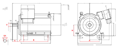

What could be the best alternative (Electrical as well as mechanical) in form of one common spare motor (Motor - D) against undermentioned three VFD operated motors i-e Motor-A, Motor-B and Motor-C ?
ELECTRICAL DETAILS:
Sr #
MOTOR
NAMEPLATE RATING
PART LOAD
RUNNING RPM
APPLICATION
1Motor-A800 kW, 690 V, 1492 RPM50 %95 %Fan
2Motor-B700 kW, 690 V, 993 RPM66 %87 %Mill
3Motor- C590 kW, 690 V, 992 RPM77 %90 %Mill
4Motor- D? kW, 690 V, ? RPMFan / Mill
MECHANICAL DETAILS:
Sr #
MOTOR
FRAME SIZE
SHAFT HEIGHT
SHAFT DIA
A
B
E + C
1Motor- A4504501208001000460
2Motor- B4504501208001000460
3Motor- C4504501107501000565
4Motor- D450450??1000?
Mechanical dimensions are in mm.
It is requested that keep focused on technical aspect instead of posting like contact OEM etc. We are already working on it with different vendors. Purpose of this post is to share ideas regarding optimum choice and major points to be considered in such type of selection.
Thanks in advance.

Your highest torque requirement is the 700kW/993RPM motor; 6731 N-m. If you then translate that to your highest speed requirement, 1492RPM, your only way to have one motor take care of all three is to get a motor capable of 6731 N-m at 1492 RPM. That will result in an 1100 kW 4 pole motor, and may not fit in that frame size. I think you need two motors minimum; a 4 pole 800kW and a 6 pole 700kW, with the smaller shaft and an adaptor bushing.

ELECTRICAL SIDE:-
Sr #
MOTOR
NAMEPLATE RATING
PART LOAD
RUNNING RPM
RUNNING TORQUE
RATED TORQUE
1 Motor-A 800 kW, 690 V, 1492 RPM 400 kW 1415 2700.00 5120 N.m
2 Motor-B 700 kW, 690 V, 993 RPM 460 kW 865 4715.00 6732 N.m
3 Motor- C 590 kW, 690 V, 992 RPM 455 kW 893 4540.00 5675 N.m
4-i Motor- D-1 800 kW, 690 V, 1492 RPM 5120 N.m
4-ii Motor- D-2 800 kW, 690 V, 992 RPM 7694 N.m
We have two options
a. Either to select 800 kW, 1492 RPM motor.
i. Its rated torque is 5120 N.m.
ii. No issue for motor-A
iii. Motor-B & Motor-C running torques are 4715 & 4520 N.m.
iv. In simple words it will be 531 kW, 992 rpm motor.
OR
b. Select 800 kW, 992 RPM motor.
i. Its rated torque will be 7694 RPM.
ii. No issue for motor-B & Motor -C
iii. When operated at 1492 RPM for Motor-A , its rated torque will be reduced from 7694 N.m to 5120 N.m. Running torque demand of Motor -A is 2700 N.m

I think one of us may have miscalculated the torque of the 2nd and 3rd motors. I assumed they were 6 pole based on the RPMs being nameplate, not as used, you likely assumed they were 4 pole and are being used at the lower speeds via the VFD.
In truth, the OP did clearly state it as the motor NAMEPLATE data, so motors 2 & 3 are 6 pole, making their rated torque HIGHER than the 4 pole motor in #1.

Instead of selecting 50 Hz motor, 60 Hz motor looks a more suitable choice.
Let Selected motor is 800 kW, 690 V, 60 Hz, 1194 RPM
i. 800 kW Motor Rated Torque: 6400 N.m @ 1194 RPM
Meet rated torque capacities of motor B ( 6732 N.m ) & C ( 5675 N.m )
ii. 800 kW Motor Rated Toque: 5120 N.m @ 1492 RPM
Meet rated torque capacities of motor A ( 5120 N.m)
FACTORS NEED FURTHER INVESTIGATION:
i. It seems convenient to operate 60 Hz motor from 40-75 Hz as compared to operate a 50 Hz motor from 40-75 Hz.
ii. One factor that need to be investigated is that what would the noise level for motor operation between 40-75 Hz operation in case of 800 kW 50 Hz as well as 800 Kw 60 Hz motor.
iii. Variable frequency drive de-rating in span of 40-75 Hz operation.

1. In my view 715 kW, 690 V, 992 RPM is the best choice.
2. Delivery time of such motor may take 18-20 weeks therefore two cement lines cannot be stopped for such long time ( if one of above motor out of three fails ).
3. Every difficult situation is resolved in steps. I am really thankful to the all participants specially JRef for addressing the issue as needed.
