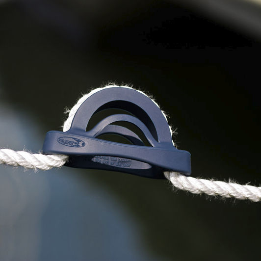

Re: Safety Tether
02/20/2018 4:21 PM
Adding something like a mooring spring or mooring absorber to your tether will spread the shock over a longer period. to which the line and the grinder and the anchor (ball hitch?) will be far more robust.

Re: Safety Tether
02/22/2018 5:01 AM
I like your idea. After doubling the rope strength (I'm now working my way through these responses) once I am advised of a kilo newton figure for sizing rope tensile strength. What harm can possible overkill do with the addition of a mooring spring or absorber.
