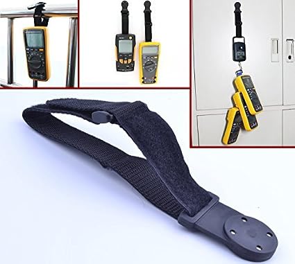

I frequently do trouble shooting in LV machine control panels, usually stooping or kneeling in some awkward position. The problem I regularly have is where to place my DMM so I can read it while using both hands to manipulate the probes.
I was thinking that I could glue a magnet to the back of the meter so that I could stick in on to any available steel surface, like the panel door, or side.
My question is, would a sufficiently strong magnet effect the function or accuracy of the meter?

Multi-Meter Magnetic Hanging Loop Strap Magnet Hang Straps & Magnet Kit Hanger For Instruments Tool Amazon.
If it were mine, I'd get some adhesive backed magnetic rubber strips and use them. Two or three strips of that stuff will work..

I got my company to get me a few of those and they are very useful for troubleshooting industrial equipment, as they allow hooking the multimeter to almost any surface (most industrial equipment is made of ferromagnetic steel).
The straps are overpriced compared with the raw materials, but the results are worth all the money.

Got one in the mail from Amazon today. It attached nicely to my DMM and I tried it in a particularly difficult to access panel, and it was just the thing that I was looking for.

I have seen cases with the Fluke range of Multimeters which have a short fabric strap with a powerful (Neodinium I would assume) magnet attached to the end so the Multimeter can hang on the side of metal panels for hands free operation.
No reason why you couldn't modify a case to add a strap with a magnet.
Strong magnetic fields can effect the accuracy of the multimeters we have found but we were measuring in the single mV range to 3 decimal places, I don't believe you would have issues in the V range of measurements.
Again a simple short strap moves the magnetic field away from the Multimeter and also allows for much more flexible mounting and positioning options that a fixed magnet does not.

I am a metrologist, I have calibrated many multimeters with the magnet attached. It has never affected the accuracy. If you are using a really powerful magnet, it might affect it, but would probably not be enough for you to notice. If you are using an analog meter, that would most likely be affected by a magnet, but those are not used much anymore. I have used the magnet made by Fluke many times, it is great and very strong. Good luck.

As long as the multimeter is digital with LED or LCD display, you should be OK. However, if the meter has an analog meter on it like the old school Magnahelic meters, the magnet will screw up the meter movement.
