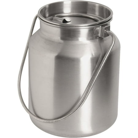

It looks like a shorty vent pipe, won't make it a tight seal, just dump....I'm also considering just running the discharge into a stainless steel gallon bucket...

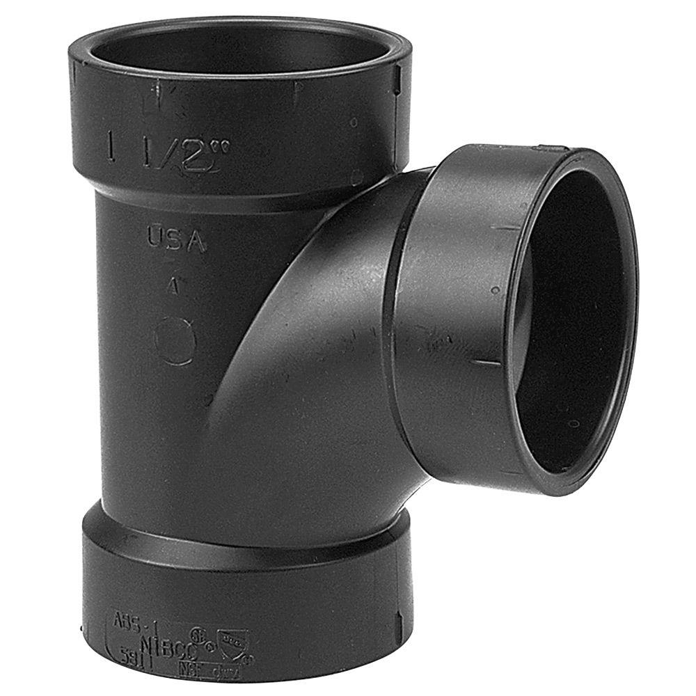

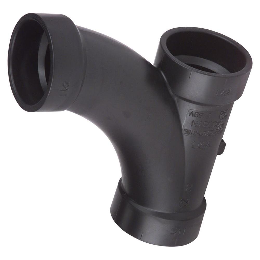

I've never had much luck with those under counter vents. But you could stack a long radius sanitary tee between the sink drain tee and the vent. the long sweep will help direct the water flow.
Also, it looks like your sink drain tee is a standard 90° tee for a cleanout, it should be a sanitary tee.

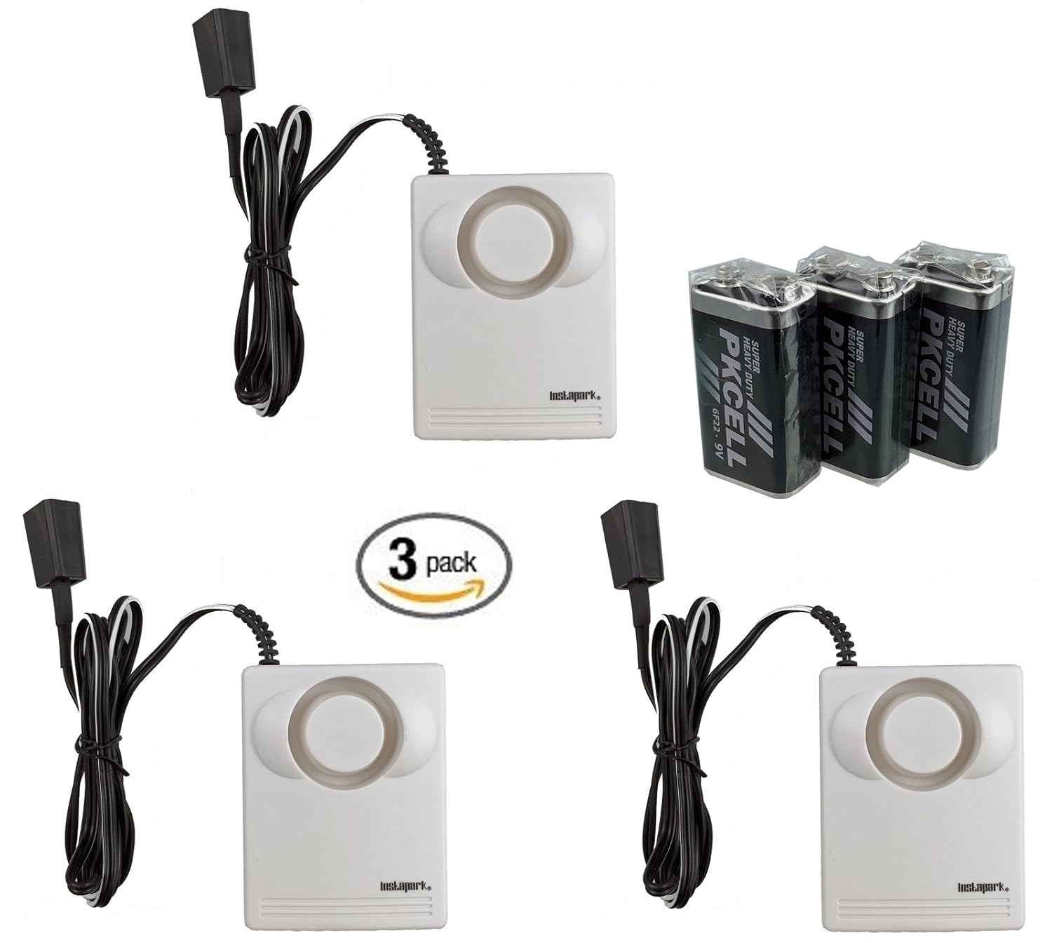

Yeah I think I'm just going to dump in a small bucket and put a water alarm in the bottom...I had a bad pressure relief valve once and never knew it was leaking until I got a high water bill....so learn from the past....I found a good deal on these alarms...3 for $20

You brought up a valid point about the air gap in the system. SE is going with a 2gal. can and water alarm. But, if he does have an event where there is a relief from the PT valve, that 2gal can is going to overflow- with or without an alarm, he'll have a mess to clean up and possible cabinet repair/ replacement from water damage. Particle board does not fair well with water.

Very true, I've seen these pop, very little water comes out, mostly steam....It then reseats, or continues to leak a trickle, in either case a 1 gal bucket is more than enough volume and the alarm adds viability...and I might add that this is the recommended alternative to a floor drain...
