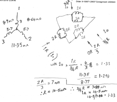

imbalance it's about 25% , below is data that we measure
using DLRO
ROTOR EXCITER
DLRO
Winding 1 - 38.90 mili Ohm
Winding 1 - 28.64 mili Ohm
Winding 2 - 311.35 mili Ohm
Re: Exciter Winding Resistance Unbalance

If these measurements were taken with the windings separated and at the winding terminations, then it appears that either one of the coils was wired in series with its group, or a coil in a parallel group has a poor joint and/or has failed open.
Posts: 1686
Good Answers: 116
07/18/2018 6:05 AM
My best interpretation of your measurement is that you have two windings per phase, Δ connected & one is open circuit - running the machine would overheat & damage the remaining winding.
Please excuse graffitti - for free advice you have to accept whatever piece of scrap paper was to hand! Figures "OK" are no-fault resistances, 2R each winding, while "1o" indicates with 1 winding Open. A "star" connection is unlikely, one half-winding would have to be shorted to match your measurements [3 ~ 5.7/2].
The 7mohm is your OK previous measurement [1R in parallel with 2 x 1R in series - 2 x 2R parallel = 1 R :all windings equal resistance 2R], while 8.77 mohm is average of your measure of two phases (third, 11.35 mOhm).
Your actual measurements high/(average of two others) gives 1.294, compared to 1.33 theoretical with 1 winding "open".
07/19/2018 1:28 PM
Dear Anonymous,
I assume you have 3 sets of phase windings on the rotor, which pass a DC field from windings fixed in the stator. These phase windings will each have two parts, diametrically opposite on the rotor. The two parts could be wired in series or parallel by design and then connected to make star or delta to connect to the rotating diodes. Since you do not tell us how the windings are arranged, one has to guess!
With a series connection, it is unlikely you could get a low resistance short directly across one of the windings with a low voltage test - it would take a metal-metal weld.
With parallel windings, it is possible a crack has spread across one winding conductor or a weld has broken at junction point - open circuiting one of the two windings which are supposed to be paralleled.
My calculation found the resistance between any two corners of the Δ with all windings connected [OK] and then with one 2R winding open circuit [1o]. With 1o, two measurements are the same & third is high. I then calculated the ideal ratio "same" to "third" as 4/3 = 1.33. This is close to the ratio of your "fault" 1o measurements 11.35/8.77 = 1.294 [getting 8.77 as mean of your measurement (8.9 + 8.64)/2 ]. Finally, I took your OK measurement (at commissioning?) of 7 mohm & equated it to the OK value of 2R/3 by the diagram to get 10.5 mohm, not far from 11.35 you measured "with fault".
It does not take long to calculate that if you have two windings 2R ohms in // in each leg of star, then, if one winding is open, you will get two readings of 3R ohms and one of 2R ohms - ratio of 3/2 = 1.5 - compared to measuring 2R three times if OK. N.B. that is two high & equal, one low, ratio 1.5 with star - it was two low & equal, one high, ratio 1.33 for Δ.
So my best shot is that you have two windings in parallel per phase with Δ connection by design, but one winding is open circuit.
Also, if you measured 7 mohm 3 times when OK, then, if you had a short in a winding, you would measure less than 7 ohms. Since your measurements are now all > 7 mohm, that is further reason to suspect a disconnection, not a short.
If you are still confused, please indicate what is confusing.
07/20/2018 9:51 AM
I have marked-up the Δ diagram with numbers for terminals, to help description. No textbook reference to give - it is all Ohm's Law, each winding 2 x R ohms = 2R. R ohms will depend on actual power of winding.
A/ All OK, no open or short, measuring 1 to 3.
  • First directly between terminals, 2R//2R. Two equal resistors in parallel are half resistance of one [2x current at same volts], 2R/2 = 1R.
  • By same method, Terminal 1 to 2 is 1R, terminal 2 to 3 is 1R. Their combined value in series is 1R+1R = 2R.
  • so circuit is reduced to "equivalent" 2R in parallel with 1R. But you could see it as 1-3, as diagram, 2 of 2R in parallel; plus another 2R in parallel. That is 3 of 2R in parallel, which will be 1/3 of resistance of each - so combined value is 2R/3 as "OK 2R/3" on diagram. The arrow means "looking into those terminals".
  • If you "look into" terminals 1-2 or 2-3, you will see identical equal values & arrangement; and calculate same OK value.
B/ Now calculate resistance looking into 1-2, with one (1) winding close to 1-2 open (o), marked (1o).
  • There is now just 2R directly between 1-2. The 2-3 + 3-1 contribution is 1R + 1R = 2R, similar to above. So circuit is reduced to 2R//2R which is 1R - as marked 1R (1o) on diagram.
  • Looking into 1-3, there is 2R (1-2)[one winding O/C] in series with 1R (2-3), a total of 3R - in parallel with 1R. But you could replace the 1R by 3 parallel resistors of 3R, so there are, in effect, 4 resistors of 3R in parallel, with value 3R/4 - as marked 3/4 R on diagram.
  • Looking into 2-3, there is a similar arrangement to 1-3, so you again get 3R/4.
All that without using the standard formula for 2 resistors in parallel.....
Rp = (R1 x R2)/(R1 + R2)
Re-arranging gets R2 = (Rp x R1)/(R1-Rp) which gives the resistance R2 to put in parallel with R1 to get a desired smaller resistance Rp.
Noting that is the (Known Value x known value)/(known value minus known value), to reduce a resistor's value [without getting a negative value "underneath"] is my way of remembering formula as similar to the usual one.
This is usefull when you want a resistor which is not a standard manufactured value or if you have packets of resistance R1 & R2 but none Rp. Sometimes you have to put 3 resistors in parallel or "two series in parallel with one" to get the +/-0.1% tolerance value needed.
In practice, you may not know the value 2R, so you only have two similar resistances and one different to work with. So the ratio high/low is calculated as the "flag" number to indicate if you have a problem & if star or Δ applies. If you have a "short" then some resistance readings must be lower than OK commissioning measurements, you cannot have two distinctly higher values as for O/C winding.
Practically, all windings need to be at same temperature when measured and a variation of +/- 5% can be expected due to wire tolerances of diameter & length [making it difficult to confirm a short of a few turns by DC resistance - but applying low voltage AC would show current difference from good winding/phase.

OK Now i got it
thank you for your detail explanation
Join Date: Jul 2018
07/20/2018 8:37 AM
thank you! I got your point. The measurement ~ the calculation result as you assume 1 one winding open.
