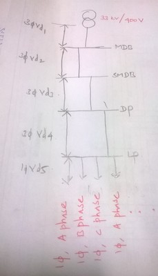

Which is the correct equation for calculating the cumulative voltage drop?
For example, the power supply sequence is Transformer --> MDB --> SMDB ---> DP ---> LP ---> 1PHASE FINAL CIRCUIT
VD1 = 3 Phase voltage drop from transformer to MDB
VD2 = 3 Phase voltage drop from MDB to SMDB
VD3 = 3 Phase voltage drop from SMDB to DP
VD4 = 3 Phase voltage drop from DP to LP
VD5 = 1 Phase voltage drop from LP to FINAL CIRCUIT
Cumulative VD = VD1+VD2+VD3+VD4+VD5
(OR)
Cumulative VD = (VD1+VD2+VD3+VD4)/1.732 +VD5
If the second equation is correct, why do we have to divide the three phase voltage drops by 1.732?

It depends on your circuit.
If your final single phase circuit is phase-to-neutral and you measure your voltages at the 3 phase points as phase-to-phase, then you divide the 3 phase voltage measurements by the square root of 3 (1.732...) to calculate the voltage drop you would have measured if you had been measuring phase-to-neutral at the 3 phase points.

...though this assumes that there is no other load on the circuit. Without the original poster's circuit description, it is impossible to tell.

There are other single phase lighting circuits.

What's the point of adding all the drops? The sum of the drops is just the initial voltage minus the final one, correcting for whether it is phase-to-phase or phase-to-neutral of course.
You can, however, look at each individual IR drop to show where a possible trouble spot is.
