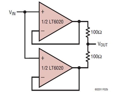

The schematic shows that the two amplifiers on the assembly are driven 180 degrees out of phase. Note from the physical layout that the two circuits are carefully matched (length of transmission lines) so that the two outputs will 180 degrees out of phase and are then used to push/pull drive the output transmission line.
It seems that you could combine 2, 3, or 4 assemblies together, which would require making sure the inputs were in phase and the amplifiers were all matched to each other in gain and delay so that the outputs would also be in phase.
So, in theory, I believe it can be done but with careful attention to RF circuit design layout principles. The more amplifiers that are paralleled, the lower the output impedance of the combination. For optimum power transfer, the output impedance of the assembly of amplifiers should match the impedance looking into the load which will probably require some sort of matching network.
However, I would contact the vendor for a final ruling...
Example circuit:
http://www.analog.com/en/technical-articles/paralleling-amplifiers-increases-output-drive.html
