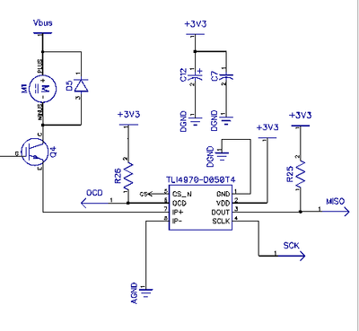

This is the circuit. I thought of placing the sensor in series with the motor after I got my PCB. Unfortunately, I have to use it like that for now. For a future design, I will consider putting it in series with the motor. So, how fast would you read the current in this circuit?
Re: How to Choose A Suitable Sampling Frequency for this Current Sensor?
10/14/2018 6:31 PM
We're back where we started. Sample at a rate not related to the switching rate so that the sample points will be distributed across the pwm cycle. Sampling as fast as possible will give the most accurate result, but will result in a greater computation load in averaging. In lieu of averaging, you could sample at a time when the IGBT is on and multiply by the pwm ratio. It should give you the same answer.
Changes in motor current will be driven by two factors: pwm variations (drive signal) and change in motor load (change in speed and back emf of motor). How fast these factors change depend on your application. If these change slowly, you may be able to reduce sampling rate and reduce processing load.
It's all a trade-off. What works best for you may require experimentation. If possible, make it a variable that you can change after testing.

Right from the first, you have had the Hall effect current sensor measuring the FET/IGBT current - not the motor current.
For confusion, as well as serial current value output, the hall sensor has a fast overcurrent detection (analog) with a response time of a few microseconds [activation current settable to 90 amp, presumably greater currents will still activate since it is an analog circuit], which could be used via an interrupt on the microcontroller [or hard wire logic] to save the power switch [FET/IGBT] even from short circuit fault.

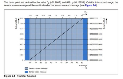

In the TLI4970 input ADC [sigma-delta type], a current proportional to Hall output is fed into an integrator [capacitor]. When the integrator output voltage indicates a certain amount of charge Q has been added, a compensating pulse of charge Q is clocked-in. Over 4096 clock cycles, the number of compensating pulses is totalled and is proportional to the measured input. By offsetting the input, the measurement is made bi-directional [+/- polarity].
This works fine if the input is constant during the 4096 cycles. But the data sheet Table 3-3 indicates 80000 updates a second or 12 microseconds between reads. If the Hall current is in 5 μsec pulses every 10 microseconds, there can be [e.g.] 2.5 μsec of input in one measurement & 2.5 μsec in the next - because the input overlaps two measuring periods.
Thus the phasing of time between FET current pulses and the measuring cycle can cause big errors. Practically, this phasing will drift about due to frequency & phase of motor pulses & ADC clock.
Using 5MHz clock [see Table 4-1], the SPI serial connection has a sampling interval of 3 μsec & seems a lesser cause of sampling problems.
The block diagram Fig 2-2 of data sheet shows filters are after ADC or in DSP - so they are not contributing a smoothed input during ADC measurement cycle. However, there may be filters before ADC or due to its integrator capacitor - getting a measurement from SPI & checking its accuracy & fluctuation sample to sample would establish what can be got.
However it seems the SPI output would be usable if the motor current was measured, by relocating primary connection, as suggested by other posts. You will not be able to use sensor for fast overcurrent protection of FET/IGBT.
It is suggested you just cut tracks on PCB & use insulated wires to feed motor current into current sensor till you have got a working design - else you may make several more PCB!!
Note, if the FET current exceeds 52 amps, the SPI output goes into over-range STATUS mode - if motor mean current of 25 amps or more is required at low speed, requiring peak currents over 52 amps this could be a problem.

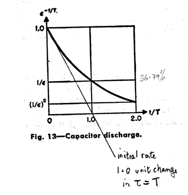

While FET is off, motor current will reduce according to exponential time constant T; L/R = 1ms = 1000 μs.
It is usefull to note the initial fall rate is such that, if maintained, the current would fall to zero in time T & that rate changes little over first 10%-20% of time constant.(the diagram title is capacitor, but it is just as applicable to inductive decay).
So with a time of 5 μs before FET turns on again, current will fall only by 5/1000, or 0.5% of initial value which can be neglected.
The next pulse will increase motor current from 0.17 to 0.34 amps etc, so after 1000 μs the current will be 0.17 x 1000/10 = 17 amps.
