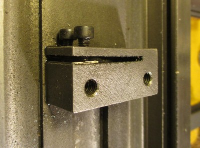

I posted about my mini mill and the anti backlash adjustment some time back.
The issue was never resolved, but now I've been using the mill a good deal, and I'm more familiar with it. I'm really noticing the backlash, so...
Close examination showed the anti backlash screws were screwing in too far and binding up where they were pressing into the body of the nut, without actually moving the thin leaf part of the nut. It appears that the holes had been drilled too deep in manufacture and penetrated into the body of the nut.
I made a little pressure plate from a piece of bandsaw blade with the teeth ground off and fitted that into the slot (this gives the screws a hard, smooth surface to bear on).
The difference was astounding; just lightly nipping the screws up made it too tight and it barely needed finger pressure to remove the backlash.
I did the other axis, too; hopefully this will be a good general improvement to surface finish and control.

Looks like a good fix, but how is the blade piece held in place?
Re: Del Solves His Backlash Conundrum!
10/09/2018 1:07 PM
The pressure of the screws holds'em in.
I'll keep an eye on it, if they shift I can always epoxy 'em in place.

Hi Del,
Alternatively you could have loctited the end of a bolt in the threaded section of the block then hack-sawed it off flush.
10/10/2018 11:23 AM
You say the holes were too deep. I think the real problem is that they forgot to drill the clearance in the thin part. The normal method of operation is that the holes would be threaded in the thick part of the block (more threads), and oversize clearance in the thin part, so tightening the screws would narrow the gap.
It appears as though the anti-backlash screws are in line with one of the mounting screws, so they will need to be of a correct length to clamp without hitting the mounting screw, and the threaded hole should be drilled and tapped all the way to the mounting hole, for maximum thread strength.
10/10/2018 12:41 PM
Possibly, but I don't think there was any depth to the holes in the thick part. Either way would work. There are a reasonable number of threads in the thin part and it takes very little pressure to remove the backlash... just finger tight using fingers on the short end of the allen key!
