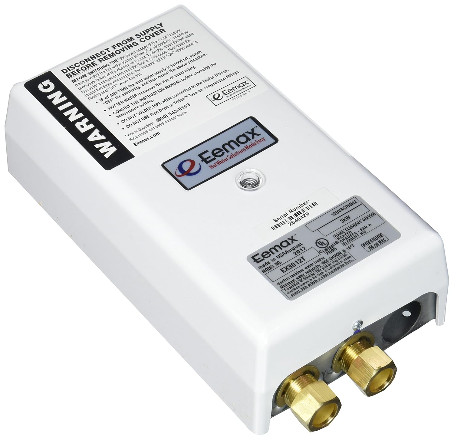

To conclude the discution about pou water heater that connects in line with the main water heater, this is what should be said about such a device:
The Eemax “Thermostatic” heater is specifically designed
to take in cold or preheated water and heat it to temperatures suitable
for the normal domestic usage up to a maximum of 140 F
Short statement, concise! I have changed my opinion about Bosch, which I considered an innovative company when, in fact, they are a bunch of technical dynosaurus that keep the same temperature control from before WW2.
The Eemax EX3012T is about $200.
Thank you, guys, for helping me with your oppinions
Bridge rule #1: Nobody is as good as he thinks about himself nor as dumb, as his partner thinks...
Re: Point of Use Water Heater (Under the Sink Heater)
11/06/2018 10:46 AM
This unit won't work well for your application....it is a tankless underpowered heater...
"Yes, the EX3012T is 110V. It could work for a bar sink(maybe). This unit will provide a 41°F temperature increase at a flow rate of 0.5 GPM. If your water flow rate is higher at 1.0 GPM, then your temperature increase will be 20°F. You would add number that to your cold water temp. to determine your output temp."
And sells for over $300 ....a waste of time and money...kitchen sink has a standard flow of 2.2 gpm...
At the standard flow rate the heating by this unit would hardly be noticeable, if at all....
https://www.amazon.com/Eemax-EX3012T-Thermostatic-Electric-Tankless/dp/B006FRA0IO/ref=sr_1_2?ie=UTF8&qid=1541518274&sr=8-2&keywords=+Eemax+EX3012T
11/06/2018 11:13 AM
I might also add that at a 3000 watt rating on a 120 volt circuit, the amp requirement would be ~25 amps. This would require a dedicated circuit and special breaker as the standard 120v max breaker size for residential use is 20 amps. All in all a lot of expense for something that doesn't really work properly. If you're going to have to go to the expense of running a dedicated circuit, why wouldn't you just run a 240v circuit?

11/06/2018 3:34 PM
Yes, it is a good idea to run an EX55T or EX65T at 240V. In fact I do have the 240V outlet from the electric stove which I replace with a gas stove. My house has been flooded by Harvey, last year, and I remodel it with new gas pipelines.
As for the temperature rise function of flow, I am not much cocerned, I do not use the high end of flow. And price is still bellow $200, on ebay, for a new device.
