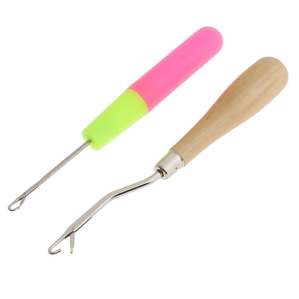

Dear All,
We are looking for a cost efficient way to produce this Needle, if possible out of carbon fiber. We are looking to produce 50,000 per day.
Can you help us out ?
Re: How Can I Produce This Needle ?
12/04/2018 1:59 PM
No one can tell from these photos how big/small it is.
What's it supposed to do?
Medical?
A LOT more information is needed, but I'd say carbon fiber is a non-starter.

A1) A knitting machine.
A2) No.

Nope, I can't help you. You present no dimensions nor any information on the environment this "crochet" hook will be used. I also find it dubious at best you have a production order of 50,000 per day when you don't know how to make one.

Seems like an ideal candidate for 3D printing.

3D printing is good for one, but not for mass production. 50,000 per day would need 50,000 3D printers.

I would guess that this is a needle for a power knitting machine and that is consistent with the quantity required. Carbon fiber to mass produce this component is a non-starter. Start with strip steel, but the width of strip you need is both expensive to buy and difficult to handle so buy say 5x the width you need and uncoil it through a slitter to create 5 thin bands that you can work simultaneously. 50,000/day is 105/minute based on an 8 hour shift. By creating 5 strands you can use a standard power press at 21 strokes/min which is much cheaper than a high speed press operating at 105 strokes/min. The cost saving will more than offset the increased tooling complexity. You will need to stamp out blanks still linked by a thin sliver of metal, then punch part of the sheet thinner to create the cavity for the moving leaf, then fold it in two along the length by roll forming, then pass it through shaped wheels to crimp the offsets in the stem, then pass it through a second and third set of shaped wheels to form the features at the blunt end, then separate by snipping the thin slivers, then hone the point, then roll form the hook, then de-grease the parts, then then dump the parts into a tumbler bowl to de-flash, then align the parts with a vibratory bowl feeder for feeding into a special purpose machine to insert the moving leaf and pin through. Including stamping out, de-greasing de-flashing aligning and inserting the moving leaf there will be about 20 separate operation to be integrated into a dedicated production line.

So good to hear someone who understands the question and then gives a great and helpful answer. I think the OP should employ you as a consultant
